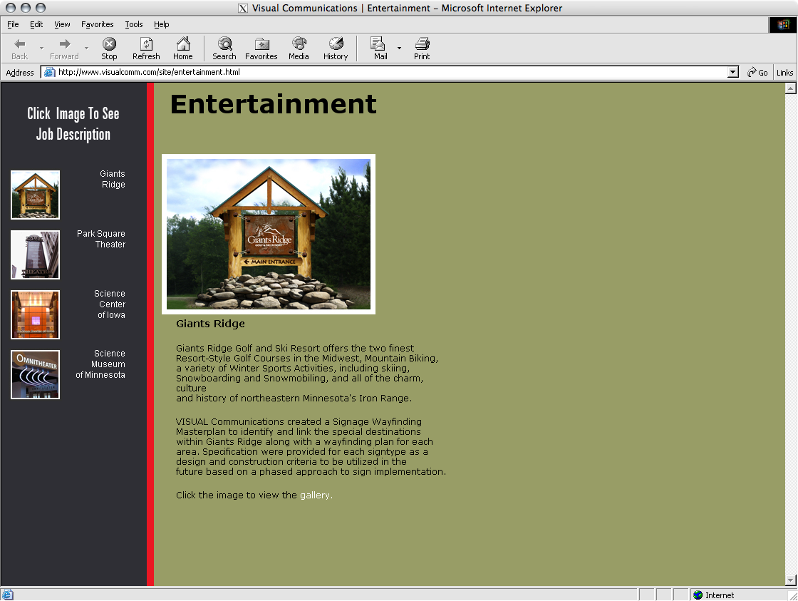

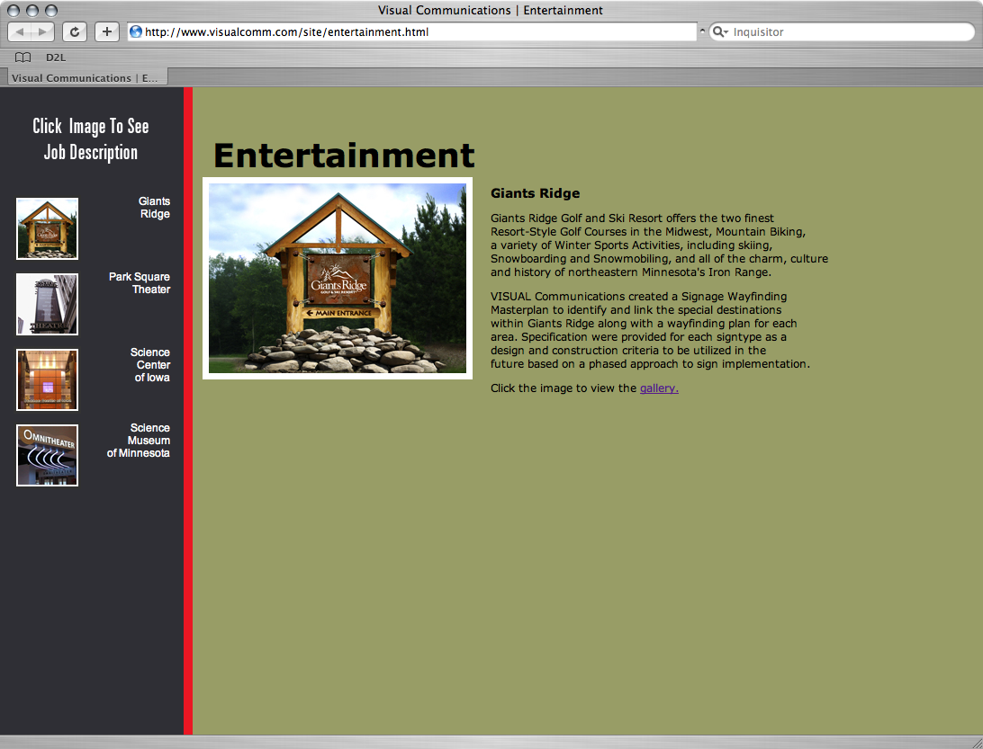

My problem seems to be a simple one, IE is improperly displaying a floated element.
The problem is this: I have two elements, an image floated left, and a block of text floated right. Simple enough. However, in IE 5+ the block of text just ends up underneath the image, but slightly indented.
I realize that the title is also misplaced in IE, I am just going to use the underscore hack to fix that momentarily.
I've attached screenshots to help
And here is the code:

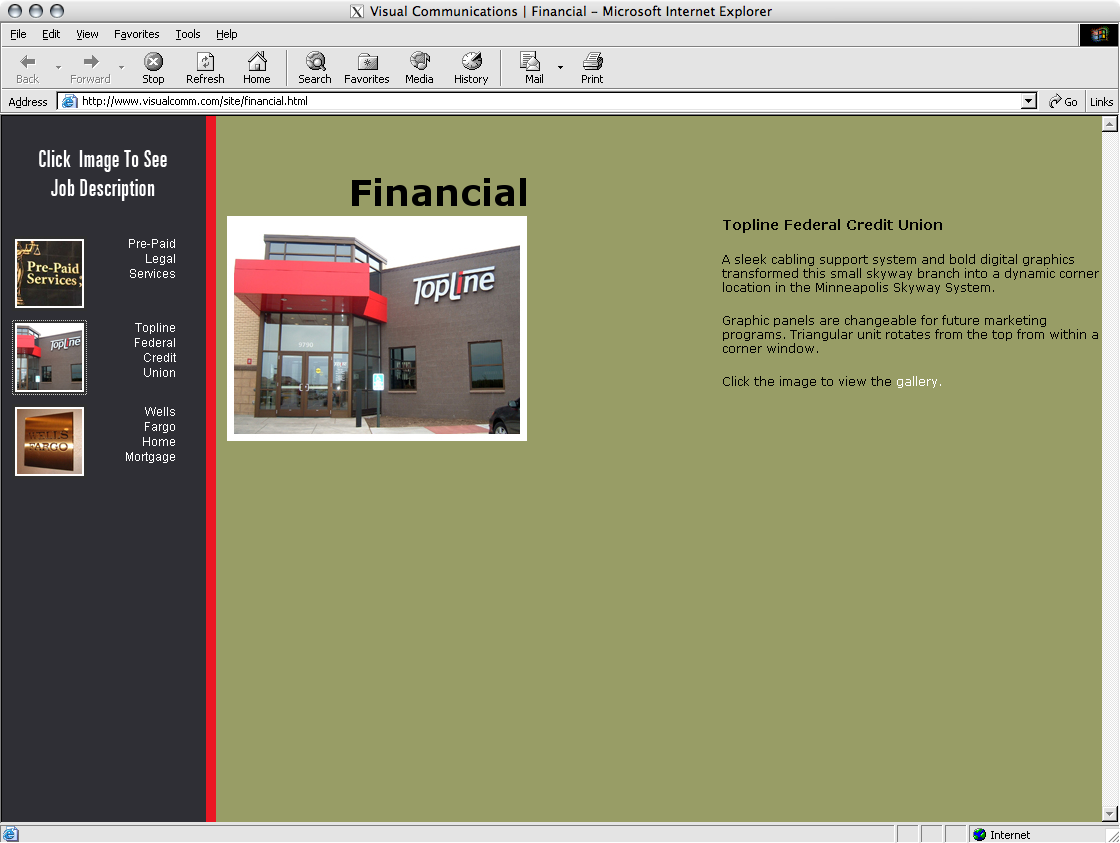

edit: ok ive added a third screenshot, apparently the float works in that one... sort of.
