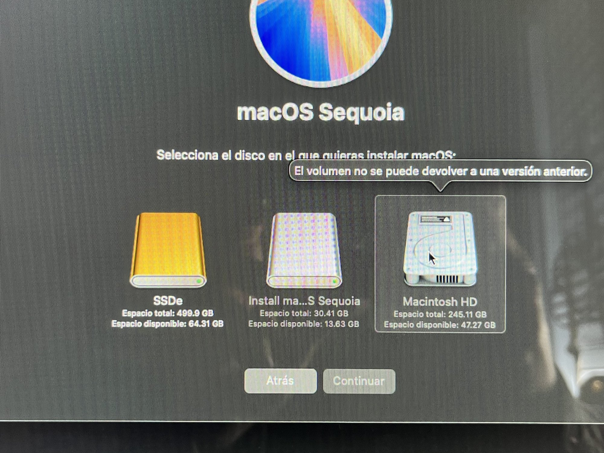

yesterday I start the process for downgrade from 15.4 beta to 15.3.1
Although I have a bootable usb with 15.3.1 and i have decided to format my primary ssd, i found that i haven’t any choose to format the ssd after boot with the usb installer
Once I boot and start the process it showed me the advice that i was not able to install over a previous system, nor rare, however I didnt found the usual Terminal window to format the ssd or the process let me do it in any way
I remember that it could be done in previously macos versions. I have a M2 mac mini, not intel
if I boot with recovery mode from primary partition it shows me the regular menus and I could try to format first from there. is it the way?

You have to roll back by booting from a bootable 15.3.1 USB installer. First use DU on the USB installer to erase the 15.4 volume pair then create a new volume. Then quit DU and run the 15.3.1 installer onto the new volume. When Setup Assistant starts at the end of the install chose to migrate from a backup. If the backup was made with 15.4 it will recommend that you update the OS before migration, but gives the option to skip, and it will migrate.

Yestaerday I can’t find DU from USB booting, neither terminal. It shows me two partition, the primar y esa unable and usb booting one

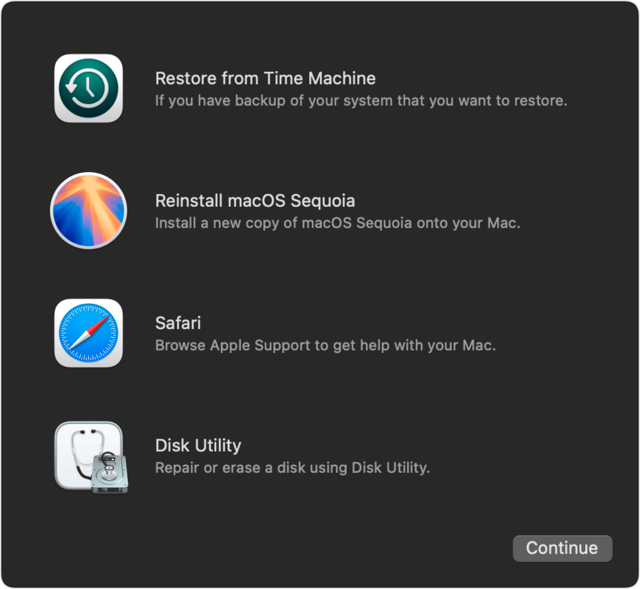

OK, so then select the USB installer from those two and it will boot to the USB Installer.
The interface when booted from a USB installer is exactly the same as booted from Recovery. Disk Utility is the bottom option in the main window, and Terminal is under Utilities in the menubar.
I share with you the screen but it's not the same as Recovery. This is what it was before but today it is not
As I said, select the Bootable installer (in the middl)e and press continue. It will boot to the installer and you will see the screen like in Recovery.

The bootable installer will be like a Recovery Partition, you have Disk Utility there and will be able to format your drive.
You just need to choose "Install macOS Sequoia" to boot from.
