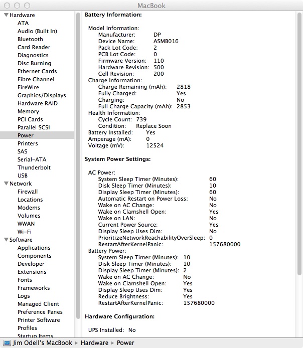

What is the battery condition and number of cycles? Use iStat Pro or iStat Menus to get accurate readings of your battery, temps, fan speeds and much more.
Don't worry! I have a MacBook with a dead battery and I just keep it plugged in, as a desktop. It also means for a quick way of tuning it off, just twitch the MagSafe 😉 (ps don't do this or you can damage the computer!)
Ditto, it will work ok plugged in.
You can also check About This Mac as seen below. As you can prolly see this battery needs replacing too:

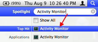

WHERE do I find the ACTIVITY MONITOR
