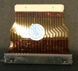

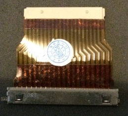

Yup. Had that problem when I did the mod on my 6411 which had a dead pixel (any excuse to tinker). Most Clamshells had Samsung panels so I needed to find an adapter which I managed to get hold of pretty easily then. It was just a straight pin to pin adapter, so I suppose if you really want to roll your own you could remove the LCD cable from the Clamshell's Samsung display and graft it onto the donor LG panel. It won't be easy but I'm sure it could be done.
Yah I managed to get one of those, too. It was apparently their last one. Unfortunately, it was faulty. I still have it. It’s still faulty.
What I ended up doing instead was finding another, I guess, “adapter”, except it was little more than the plug insert into the LG display on one end and just twenty individual wires (all pale pink) going to nowhere. I ended up having to pore through wiring diagrams for both the LG and the Samsung panels, making certain that these pink wires were routed to the right pins on the board connection end (using a donor Samsung cable I cut) and then soldering those two halves together. I think that was my first truly successful soldering project. I remember flinging my arms straight up when the screen lit up and the grey  appeared and screaming, “IT WORKS! IT WORKS!”
