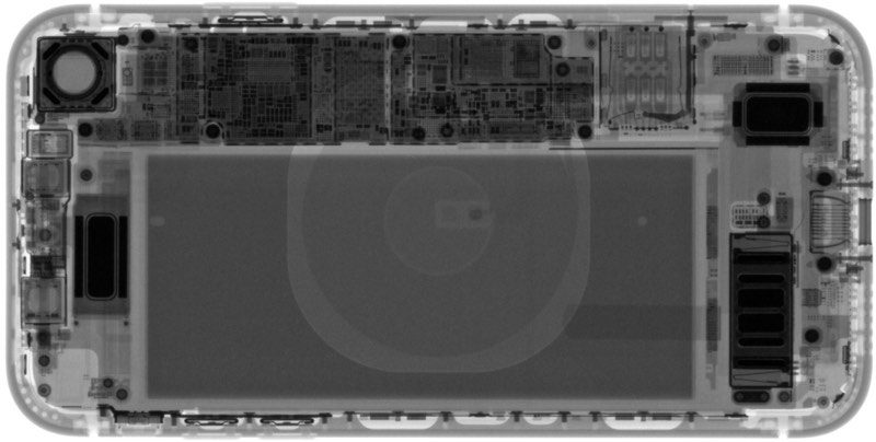

An x-ray provided by Creative Electron offers a look inside the fully assembled iPhone, showing where each component is located.

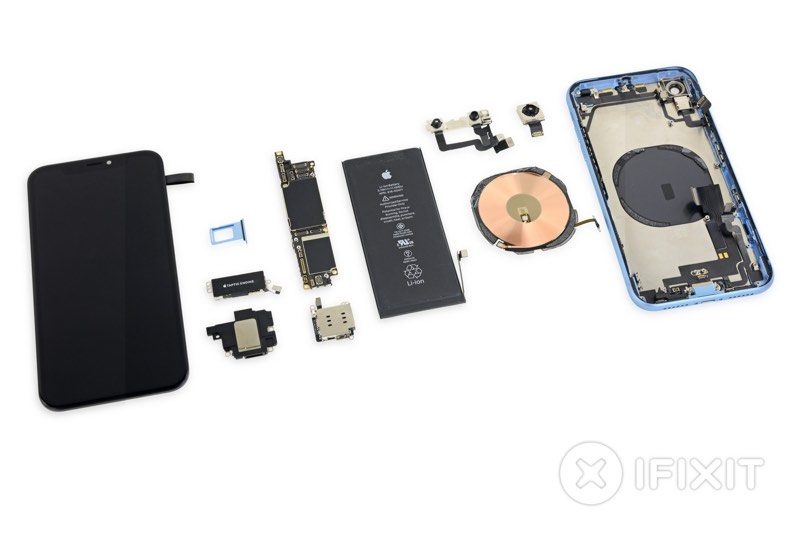

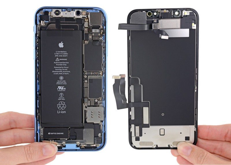

The internals of the iPhone XR look like a cross between an iPhone 8 and an iPhone X, according to iFixit, with a rectangular battery and a rectangular logic board.
The iPhone XR has an 11.16 Wh battery, larger than the 10.13 Wh battery in the iPhone XS, but smaller than the 12.08 Wh battery in the iPhone XS Max. Despite the smaller battery, the iPhone XR gets the best battery life out of Apple's three new iPhones. There's an included Taptic Engine, which provides the Haptic Touch feedback that's available in place of 3D Touch, and a single-lens rear camera module.
The TrueDepth camera system is, unsurprisingly, identical to the TrueDepth camera system in the iPhone X and XS.
The XR is equipped with an LCD that's 0.3 inches larger across than the AMOLED display in the iPhone XS, and it's also thicker and heavier because it requires a backlight. According to iFixit, the larger display is the reason why the Lightning connector is off-axis.
Like the iPhone XS and XS Max, the iPhone XR features a copper wireless charging coil, which should allow for faster wireless charging speeds due to less heat produced.
iFixit gave the iPhone XR an overall repairability score of six. A broken display can easily be replaced with minimal hardware removal, says the site, but Pentalobe screws and waterproofing complicate things.

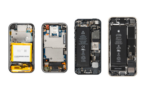

That’s a pretty damn big battery. As dies keep shrinking, the battery will eventually make 95% of the total volume of the phone.

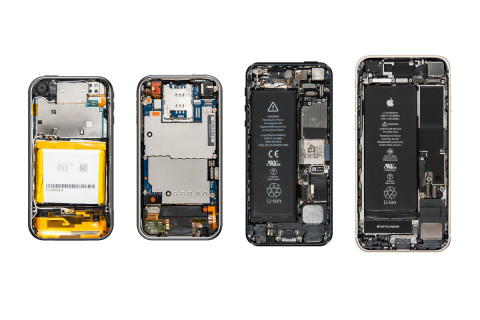

What comes to mind when I see this was the quote by Steve Jobs along the lines of how the inside of Apple products should look better than the outside that of the competitors. Happy to see that’s still true
Even if 90% of folks will never see the guts themselves. This is the approach that manufacturers of luxury Swiss watches use as well with the movements as well as exotic car manufacturers with their engines.

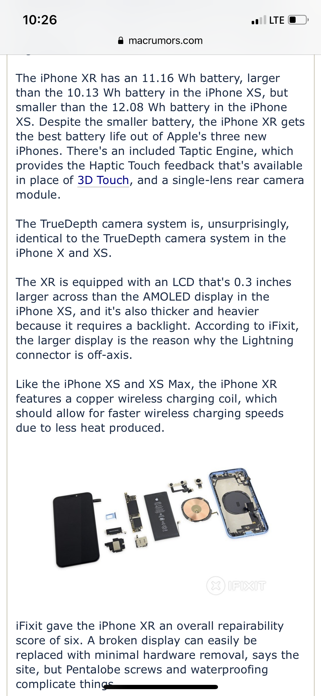

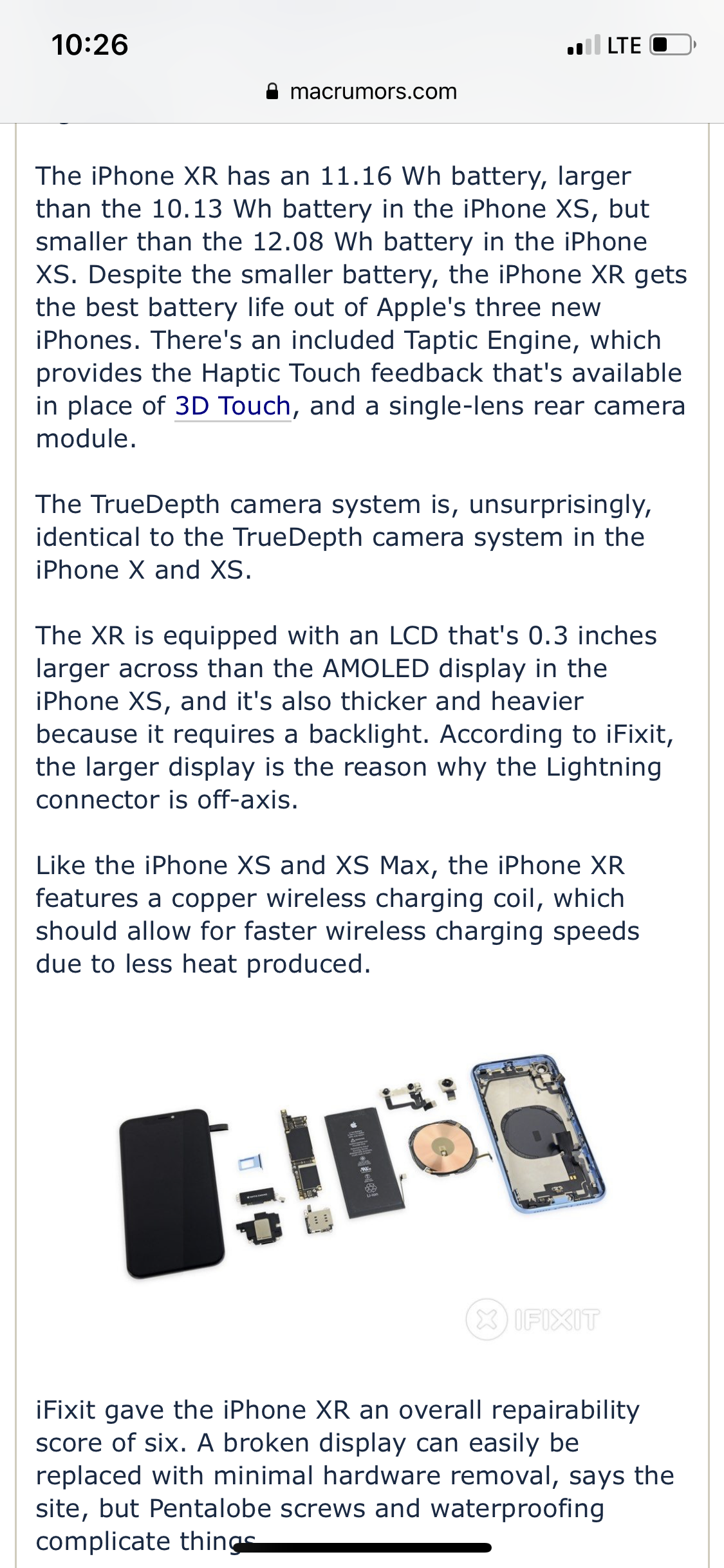

The iPhone XR has an 11.16 Wh battery, larger than the 10.13 Wh battery in the iPhone XS, but smaller than the 12.08 Wh battery in the iPhone XS.
So...it's bigger than the one in the XS, but smaller than the one in the XS...ok. Got it. Just make sure you order the bigger battery in the XS. 😉
Looks like someone forgot to put Max after the 12.08 Wh battery
The battery is both bigger and smaller then the the iPhone XS! Lmao
