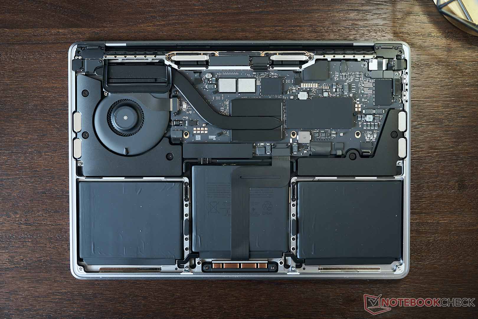

Just remember, the battery is glued down - well that adhesive tape you need to pull out slowly at an angle without tearing.
Once you tear the tape you literally need to pry battery off which increased the risk of puncturing the battery and causing a fire or explosion.
The battery is substantially larger than an iPhone so risk is substantially greater.
Can't imagine they are happy with that level of exposure to lawsuits.
No doubt Apple does not want to offer this service so doing the minimum required.

Apple this week expanded its Self Service Repair program to MacBook Air and MacBook Pro models equipped with the M1 series of chips, providing customers in the U.S. with access to select parts, manuals, and tools to repair the notebooks.
While the program's expansion is good news for the right-to-repair movement, repair guide website iFixit is not entirely pleased with the implementation. (It's worth noting that Apple is now a competitor to iFixit in this area of business.)
In a blog post, iFixit's Sam Goldheart said Apple's program manages to make the MacBook Pro seem "less repairable," primarily because Apple's current procedure for replacing a MacBook Pro's battery is prohibitively expensive and time consuming.
The issue is that Apple's program does not yet allow a customer to order a standalone replacement battery for the MacBook Pro. Instead, a customer must order a part known as the "top case," which includes a glued-in battery. Then, the customer must follow Apple's exhaustive 162-page repair manual to replace the "top case" in their MacBook Pro, as the procedure involves removing every other component from the case.
Top cases are an expensive part given that they include the keyboard, battery, speakers, and more. For example, Apple's self-service parts store charges $527 for a top case for the 14-inch MacBook Pro, making it significantly more expensive to replace a MacBook Pro's battery through the program in comparison to having an Apple Store or Apple Authorized Service Provider complete the job for $199.
"Apple is presenting DIY repairers with a excruciating gauntlet of hurdles: read 162 pages of documentation without getting intimidated and decide to do the repair anyway, pay an exorbitant amount of money for an overkill replacement part, decide whether you want to drop another 50 bucks on the tools they recommend, and do the repair yourself within 14 days, including completing the System Configuration to pair your part with your device," wrote iFixit. "Which makes us wonder, does Apple even want better repairability?"
Apple says a "battery replacement part" will be available for the MacBook Pro at some point "in the future," which could make the replacement procedure easier, although details remain slim. But even if Apple releases a standalone replacement battery, it will likely remain cheaper and easier to have Apple handle the task.

For today's laptops (and phones) to have swappable batteries like back in the old days, they would need to be thicker. Swappable batteries require more space. They need room for hinges and clamps, or, at the very least, they need their access unobstructed by other components, which also then require moving around and re-placement in spaces that might not be the most efficient, necessitating even more room inside the device.
Remember the swappable batteries on old PowerBooks? Hinges, hinges, hinges.
Also, today's batteries are not typically "bricks" or "slabs" in shape inserted into the device, like the batteries of old. They are pressed flat and spread around like a pancake to better fit in the limited available nooks and crannies available in today's thin devices.
If you want an easily swappable battery in today's MacBook Air, expect it to be much thicker or have a much worse battery life since the battery would need to take the old form factor to be easily removable – and thus have less space for power cells.
You want to know a revolutionary design they could do? Glue the battery on the bottom case instead of the top case.
Suddenly it becomes 10 times cheaper and easier to swap things without needing to emote every part of the motherboard
