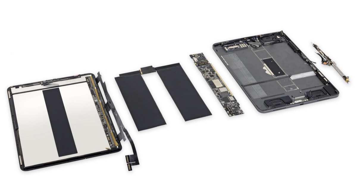

    Following teardowns of the new MacBook Air and Mac mini, the repair experts at iFixit have today published their teardown of the 11-inch iPad Pro.

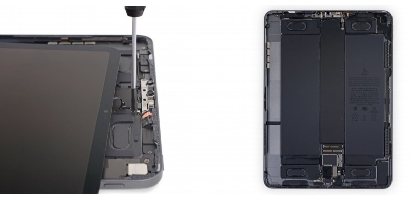

    To start, iFixit removed the display from the tablet and the first thing they noticed were the audio components of the new iPad Pro, made up of four woofers and four tweeters.
    [​IMG]
    The speakers and logic board cover impeded access to the iPad Pro's A12X Bionic chip, but eventually iFixit accessed the full logic board. On it, they found the A12X Bionic SoC, 64GB Toshiba flash storage, two Micron RAM totaling 4GB, the NFC controller, Apple's Wi-Fi/Bluetooth module, two Broadcom touch screen controllers, and a Texas Instruments power controller.

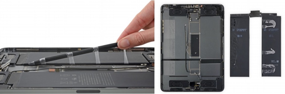

    With its sights set on the iPad Pro's battery, iFixit discovered that the 2018 tablet's battery is slightly more repairable than the previous generation. This is because Apple is again using stretch-release battery tabs again with the 11-inch iPad Pro, with six U-shaped strips in total. iFixit explained that each of these strips include two tabs, so fixers have a second chance at repairability should one of them break.
    [​IMG]
    After this smooth opening with the adhesive strips, iFixit still faced a large amount of adhesive running down the left side of the battery. Eventually, the repair experts got the battery free and found a 7,812 mAh battery running at 3.77 V for 29.45 Wh, which is a slight downgrade in comparison to the 30.8 Wh pack of the 10.5-inch iPad Pro.

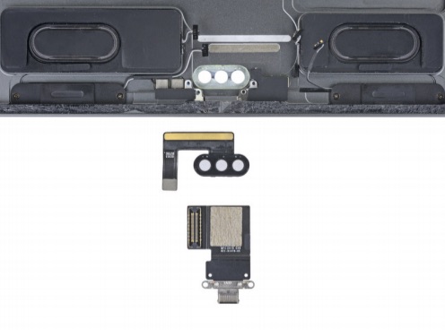

    Overall, the 11-inch iPad Pro has received a 3/10 repairability score, with 10 being the easiest to repair. The major bonuses for the new iPad Pro's repairability were the modular USB-C port and lack of a physical home button, which "eliminated a common failure point" and could further simplify repairs. Still, iFixit noted that adhesive was nearly everywhere inside of the iPad Pro, and will make all repairs more difficult.

    REALLY happy the USB-C port is modular.
    Those ports (on various devices at work) have proven to be far less resilient than Lightning port hardware. I prefer being on the standard now, and it’s nice that Apple factored in some repairs.
