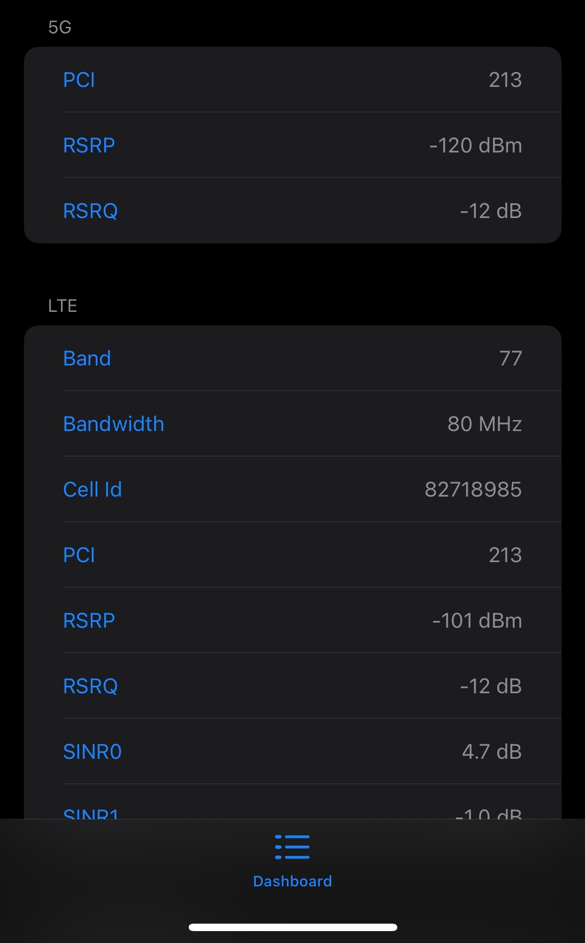

I know signal and speed are far more important to me than than a camera button! On my 15 Pro, I notice a significant difference in signal when my phone body in general is covered by an insulated (electrically) full metal bumper.
For those that don't know, RSRP is the number I am watching for what the phone is receiving from the tower / signal source. RSRP = Reference Signal Received Power
Phone not in case / bumper
Metal Bumper on
It would be silly if the new phones have weaker signal on any band due to relocating an antenna behind a metal portion of the case!

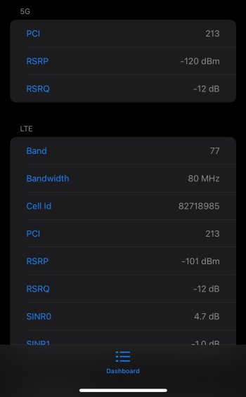

I know signal and speed are far more important to me than than a camera button! I on my 15 Pro, I notice a significant difference in signal when my phone body in general is covered by an insulated (electrically) full metal bumper.
Metal Bumper on
