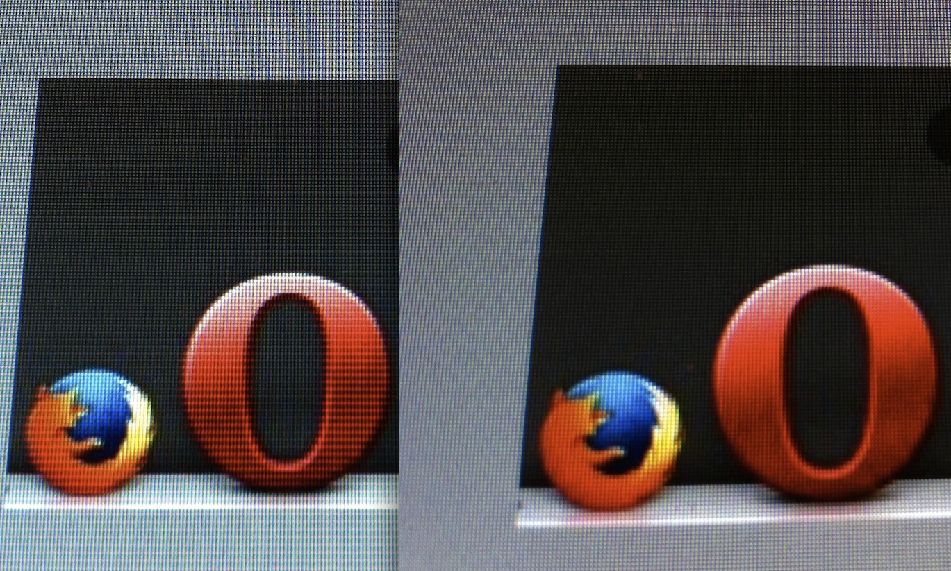

Suddenly some very strange behaviour on one of my monitors (PLT2234 Display - iiyama ProLite TF2234MC-B1 22" IPS LED Touchscreen Monitor). It looks like that at the left side (half of the monitor) the icons are missing horizontal line in-between.
See the combined screen of photo's I took with my iPhone:
Also I see more white horizontal pixel lines in-between on the left side that are not on the right side of this monitor. Drivers, GPU or monitor? Rebooted couple of times...

Not sure if this solves the problem. You can try to remove the video cards, and put them back in. Or maybe a loose cable problem.
support ticket
Thanks for your reply! Done all of that.. Going to file a support ticket at IIyama CS. Keep you posted.
~ Cheers
Interesting, I was going to say a bad cable as well. Have you tried swapping cables or replacing one?
Yes, swapped cables too. Strange that this issue covers 1/3 (left - up to down side) of my monitor.
~ Cheers
My first guess would have been cable, second guess would be VRam ... but swapping the monitors would have the problem staying with the video channel that is defective. Since the problem follows the monitor, it has to be the monitor. 🙂 Possibly bad matrix decoding or internal connector issues?
~ Cheers
Very strange.
I am going to say it has to be the monitor, very weird though. Please keep us posted on what this turns out to be.
