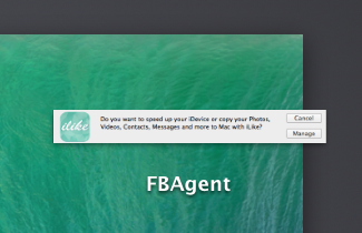

I downloaded a free tiral of iLike on my Mac. I decided I didn't need it and so I deleted it (dragged it to the trash). However I am periodically getting notifications from the application as if it was still there.
https://www.macupdate.com/app/mac/49240/ilike
I would like to remove this notification but I looked in library preferences, application support and can't find any file that seemed to control this notification.
I noticed when using Mission Control that the notification displayed as FBAgent.
I had previously searched for "ilike" in the library which is why I didn't find this guy. It's actually located in home/Library/Application Support/FBAgent
Even though I removed this, every time I plug in my iPhone or iPad the message still pops up. I've even tried installing it again and then used Clean My Mac 2 to uninstall the app, with no luck.
Has anyone successfully removed this?
