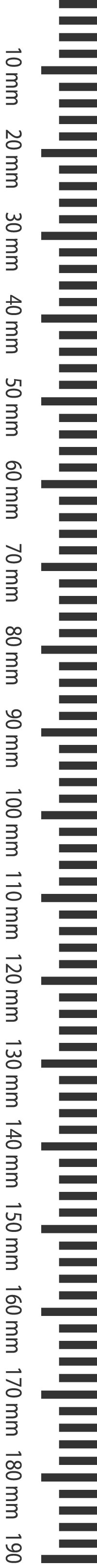

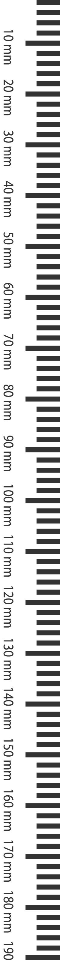

I'm trying to create this effect on ruler markings and the whole of the ruler so it's the length of the page and a nice effect. I've tried using a radial gradient with blue and white but no luck. It gets a bit tricky have to remove stoke and fill.
Can anyone recommend any tutorials for this on a line. I've done this effect on rectangle but bit trickier on line😱. I think they may not be possible on a line as it just shows a line as the fill. How do I convert these to rectangles?

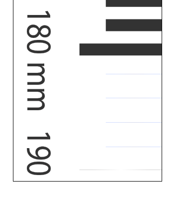

I understand Kwill:
See this picture attached. The 5 ruler markings on the bottom right don't have a stroke attached, but are filled with a gradient. Notice how you can barely see it as it's so small. The ones above have a massive stroke.
I guess I have to draw rectangles, It took me a long time to draw these with the pen tool I think but I don't have time to redo all this work as it's for my own business and I work 12 hours a day 6 days a week. Unfortunately as I love graphics and web design.
I'm hoping someone can conjure a remedy to my dilemma, possibly with an applescript to convert to rectangles and format with a gradient or action to do this. Or better, to format these with the pen tool.

To turn a stroke into a filled rectangle in Illustrator, select it, then choose OBJECT > Path > Outline stroke (then fill all resulting rectangles with your chosen gradient at once).
Thanks very much UTClass that's exactly what I wanted.😀 Cheers buddy 😉🙂.

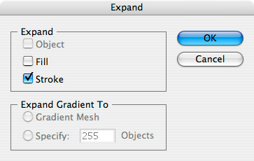

You don't need a mask. Are all the ruled lines strokes?
  1. Drag selection around all the ruled lines.
  2. Select Expand from Object menu (choosing "Stroke" only).
  3. While everything is selected, double click Gradient on toolbar.
  4. Build your gradient in the palette.
  5. Save gradient in your Swatches palette.
  6. Done.
