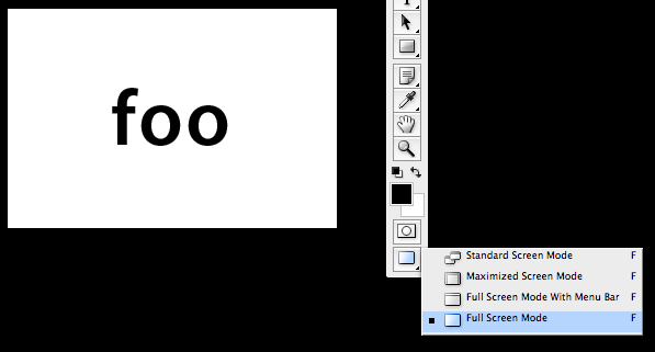

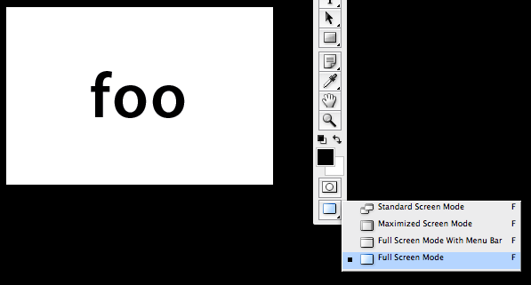

Photoshop - when you increase the window, greater then the image, it used to give me a grey background, but now it's black. anyone know how to change this back, without going back to default settings?

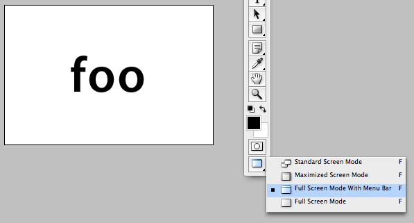

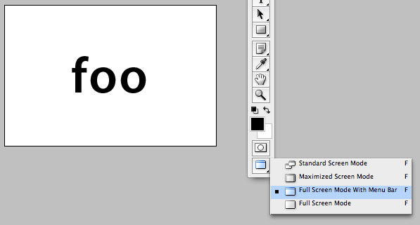

Photoshop Canvas color
Have you checked your Screen Mode? at the bottom of your Tools you'll find your Screen Mode. You may have it set to Full Screen Mode which gives you the black background click on the icon and change it to Full Screen Mode with Menu Bar. This will return your pull-down menus and your background to gray.

The linked tutorial worked for photoshop, thank you very much.
