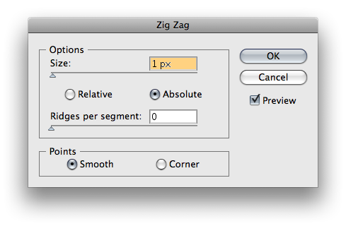

snickelfritz macrumors 65816 Jan 26, 2008 #4 my 2¢ Start with a polygon with 100 sides. Apply the zig zag filter to it, with smooth points selected. Experiment with the other zigzag settings. GL Attachments zigzag.png 31.2 KB · Views: 171 star.png 13.6 KB · Views: 175
