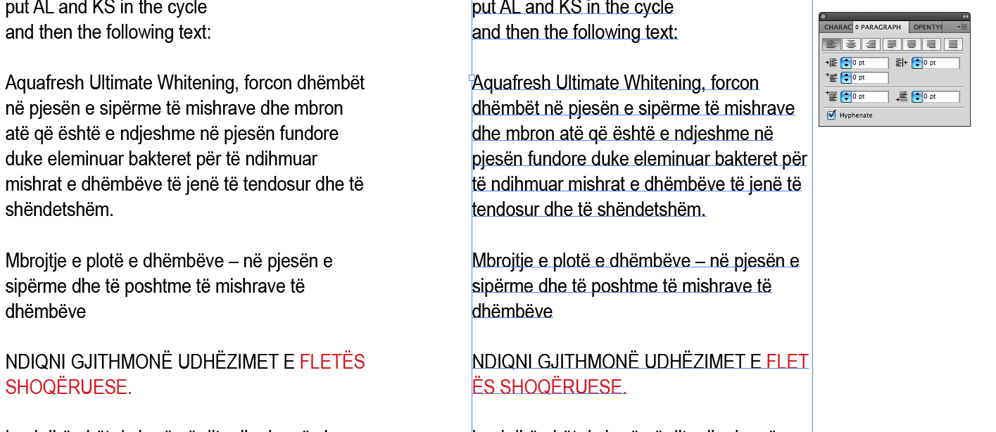

Wonder if you could help. I have a strange happening here with the text re-flowing but breaking mid word (without hypen) if the text box it is in is made smaller in width.
Can anyone advise why this is happening & what (if any) workarounds are there?
Thanks for your help in advance & I show the file below & can mail this to you for you to try also?

Sorry, not sure where you mean? I already have this:

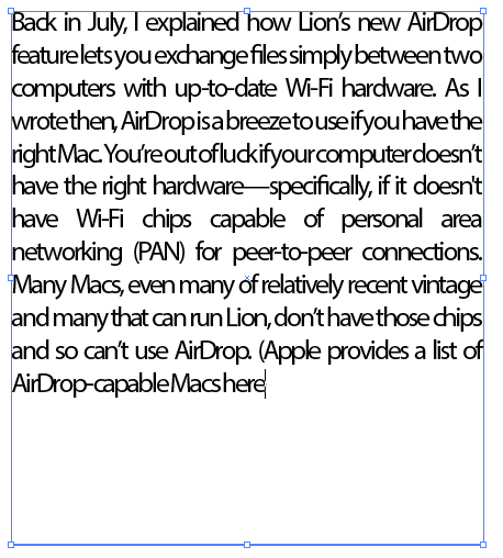

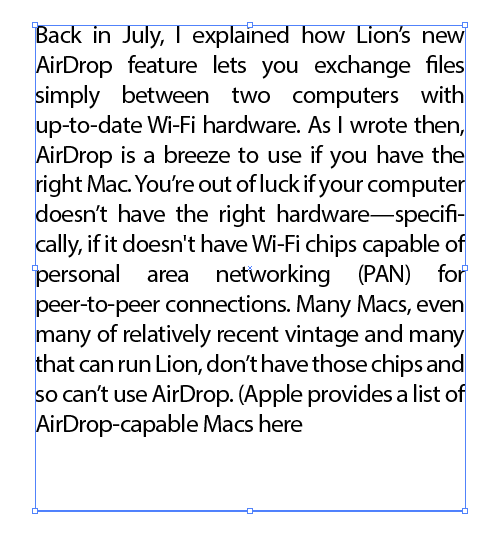

Under Character Tab, which you will see with attached photos, you will see what I have done with Kerning & Tracking. There are 2 photos of the kerning & tracking set at different positions and what it has done to some type I have set in a text box. Play around with those settings and you will find something you like. If not you can email me file at fyredept@telusplanet.net and I will have a look at it. even though the screen shots look different size, they are actually same size box.

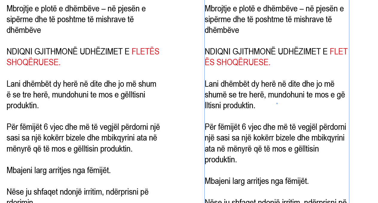

Hi Firedept, firstly thank you for your response.
The problem lies with the text is supplied to be pasted into an existing text box on an artwork which I would expect to flow correctly. However the text will line break mid word without hypens which will make the info wrong.
I will send you the file via email to show what I mean, & I have coloured up a couple of words with a spot colour to show the problem when re-sizing the box.
Thanks again for your help & hopefully you can solve it!🙂

Unfortunately not. The text is coming from outside of the application & as said is being pasted into an existing text box but re-flowing without hypens. It seems the problem (thanks to firedept) lies with Illustrator not knowing the dictionary language & hence not knowing where to hyphenate.
However, I have tested a bit more (firedept this may be of interest) & in CS4 this does not happen!.......
