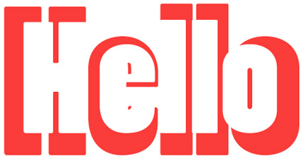

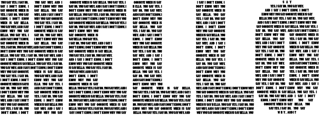

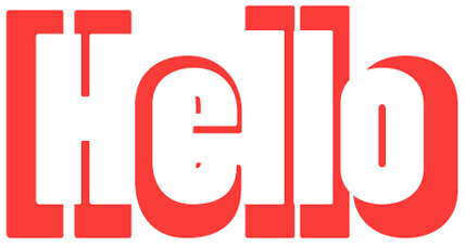

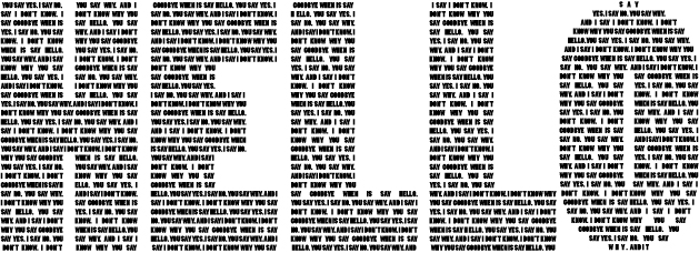

You could use the Type Area Tool with justified small text or place one word over another in search for interesting negative space. I guess it depends on how large the word(s) within the word will be...
if you use the type tool to make text you can select the text and hit shift+cmd+O and convert it to an outline instead of tracing with the pen tool
That's exactly how I want it to look. However - How did you manage to type it into Hello? The word I am using is Anniversary. I tried using the area type tool but it says it can't. So then I tried turning it into an outline, figuring it will recognize it as a shape but still it won't let me. The only way I have been able to get it to work is by using the pen tool. However, sadly, I am not very good with it and tracing the word Anniversary isn't working out.

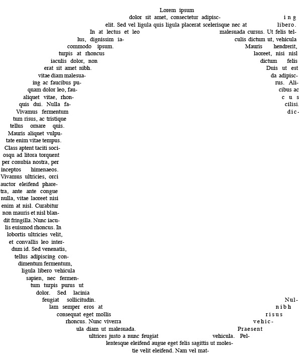

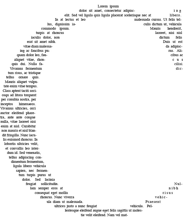

Your best bet would be to try InDesign…
Create the word, convert to Outlines… Then under the Object menu, select Content and choose Text.
Copy the text you want and Paste inside the letters… (Below I just used Lorem Ipsum etc).
That way none of your words (names) will be cut off or truncated.
Play about with the settings to get it nice and smooth.
Like this…

Illustrator: Text was converted to outlines, then ungrouped and compound paths released. The Area Type Tool was used to click on the first letter. Type or paste text. With the text tool, click the overflow square and select the next letter, more text, and so on.
The "o" was a bit tricky. It had to be converted to one object so upon close examination you will notice a thin vertical space is apparent that connects the center to the bottom edge. You'd have to do something similar with your a's in "Anniversary."
