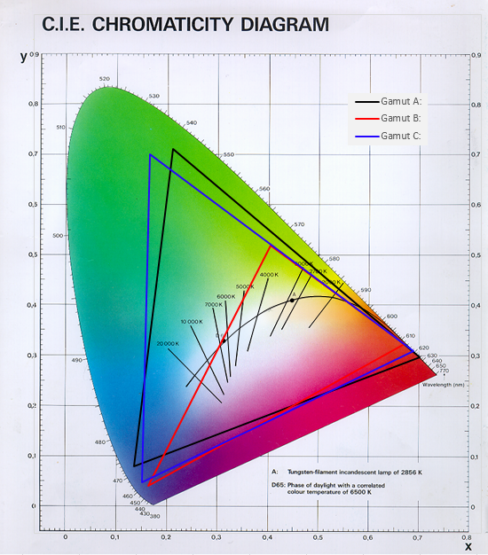

If you don't mind, can you tell me which brand/lights are doing your 'green'? I steered away from Hue because I read many a complaint about its green color which is the most important color to me. The green lights in your pics look great and I was curious who made them.
For what it's worth, Hue's problems with green are with old equipment - Hue has had 3 generations of its main lights, and the first two did have a limited color gamut (with substantial omissions in green and some in lighter blues), but the current generation does green quite well. In the graph below (from here), the older generations of lights could reproduce colors in the red triangle, while the current generation of lights cover the blue triangle.
