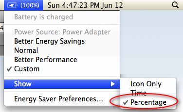

Can we change the maH reading to a percentage on the new MBP?
If you're referring to the Menu Bar icon, just click to select from the menu.

No, you can't change Hardware Overview to show a percentage, but you can use the Menu Bar icon or iStat Pro for that.
The menu bar icon for life real time left on battery, but I may have read this wrong, but isn't the mah reading for battery health over a period of time. Just wondered what it's reading now, because I'm sure this new MBP's battery is not giving me what it should. The percentage goes so quick, Even the iPhone holds 100% after a bit of use.. Although that does get charged every day too
My mistake. I thought you were asking about the charge remaining. Yes, the battery health, described as mAh in Hardware Overview, can be viewed as a percentage using any of the 3 apps mentioned in the CHECKING STATUS AND HEALTH section of the Battery FAQ. It doesn't show on the Menu Bar.
