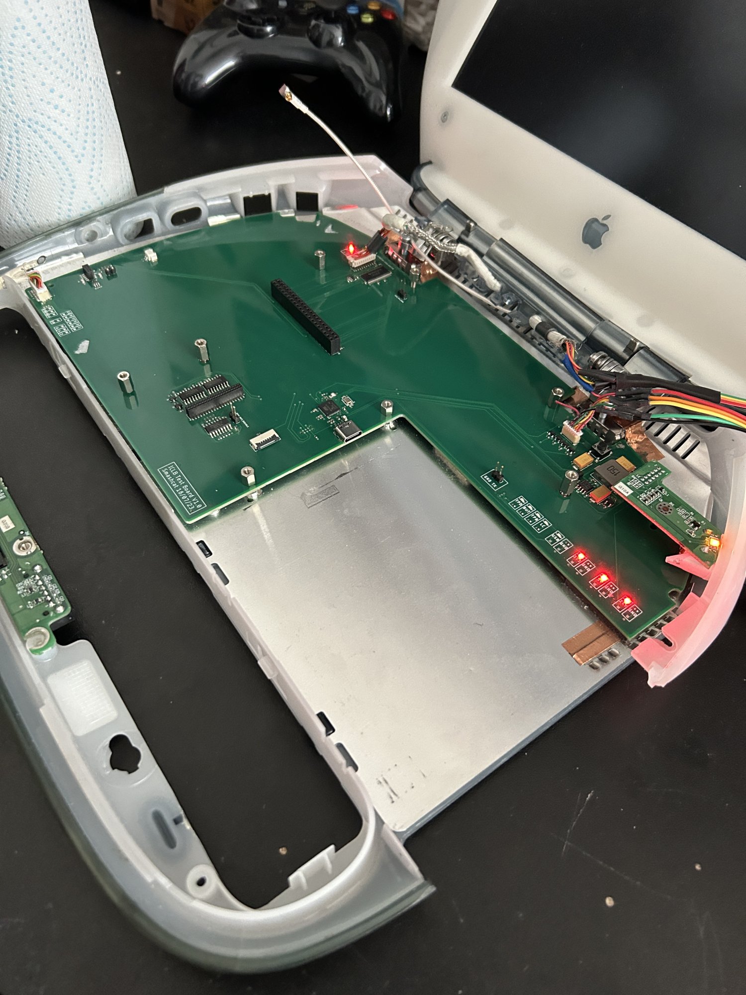

I decided I wanted an iBook that would be usable as a "coffee shop" machine when I'm out and about, so I've designed a new logic board to swap into my G3 clamshell, using the original screen, keyboard, trackpad, power supply etc, but giving it a lot more power, BlueTooth, WiFi etc using a Raspberry Pi CM4 compute module. My first prototype board is in the video below (there are a couple on my channel) - first showing it running dual-screen, the internal 800x600 display + 4K HDMI output 🙂 Then playing some Dreamcast games via emulation. The 4:3 screen is perfect for console emulation, and BlueTooth means I can also use a console controller.
The current PCB has extra LEDs to help me with debugging and testing, which are showing through the casing but they will not be there in the final design. I'm also designing a keyboard lighting PCB to go under the original keyboard and allow per-key lighting for animations - all white LEDs, but I will be able to change the brightness of each at around 100fps for smooth effects. It will respond to keypresses too, so things like rippling light out from keys as they're pressed etc should look cool. This second PCB will use its own microcontroller to handle the animation so it doesn't use any CPU from the Pi. The trackpad, keyboard, backlight and some other aspects are handled by another microcontroller on the logic board also.
It's been a fun project so far, and I'm looking forward to getting it out into the wild 🙂

Thanks, yes I designed the new logic board to use everything else from the original iBook - so I have the same connectors, and positions, including for the power and audio daughter-boards. My plan has always been to make it a straight swap that is reversible. So no cut cables etc. There are no off-the-shelf parts apart from the Pi4/CM4. The one thing it doesn't use is the DVD ROM. I didn't really see any need for it. I'll be making a 3D-printed bracket to hold the cover on the case, but it won't be functional.
"purists" can do what they like with their own devices 🙂 I've always just liked the look of the clamshell case, so wanted one that was usable. It's currently running Pi OS, or RetroPi - I'm making a custom build of RetroPi for this setup, so it can maybe also take advantage of the key lighting to maybe light the keys a game uses, etc. although having BlueTooth controllers makes it a bit obsolete. Having the HDMI out allow it to be used as a retro games console in my lounge too.
I replaced the cells in the battery when I first got the laptop and it charges fine. The new board will still allow charging the same way. You're right, it uses far less power than the original board. I'm estimating up to around 10-11 hours between charges, depending on what it's doing. I limit the backlight brightness to 80% (the same keys are used to adjust) as it just uses a lot more power over that with no real change in brightness. From my tests with a scope, Apple did the same.
I found some interesting things when reverse-engineering the original board. For example, it can only output 18bit colour to the LCD, even though OSX has the option for "millions of colours" - the actual number is around 262,000 🙂 The ATi GPU can do 24bit colour, so maybe the marketing people came up with that. My one here was a 466mhz with Firewire, so I'm assuming all of them are the same with the actual colour depth...
Here's the current prototyping logic board - it has extra LEDs and headers for testing, and the USB and HDMI circuitry isn't on there as yet (it's on a separate test board I've made here) - oh, the ugly ribbons at the top were a temporary hack so I could test driving the LCD backlight with my signal generator to test the limits etc. I've reverted it back to normal now.

Ohhhh you added a picture of the internals!! That is awesome, not what I was expecting (much cleaner).

Heh, thanks, yes it will have some more components once the USB, HDMI circuits, microcontroller for the keyboard lighting and CM4 module socket is added onto the main board, but the general layout is pretty much there. It'll look fairly empty! I haven't really decided if I'd sell them; if there's enough interest I can get a batch made once it's all done! It'd be nice to see another one out in the wild!

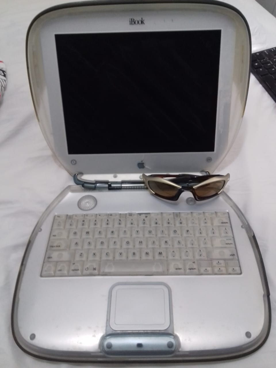

I'm typing from Brazil and my dream is also to make my clamshell usable, I search the entire internet for ways to do this and my two options are to use a smartphone logic board with LOTS of adaptations or a Raspberry board with some adaptations, you actually finished this project successfully and I congratulate you for it, I hope it helps me make my dream come true. I have a question for you, could you use a logic board from the Orange Pi 5 Plus? I'm thinking about changing the screen for a 12.1-inch 1400 x 1050 resolution from the Thinkpad X60/61/62. I would definitely buy your modification projects involving the Ibook G3 Clamshell and I'm looking forward to it. Sorry if I wrote something wrong, I'm using Google translate.

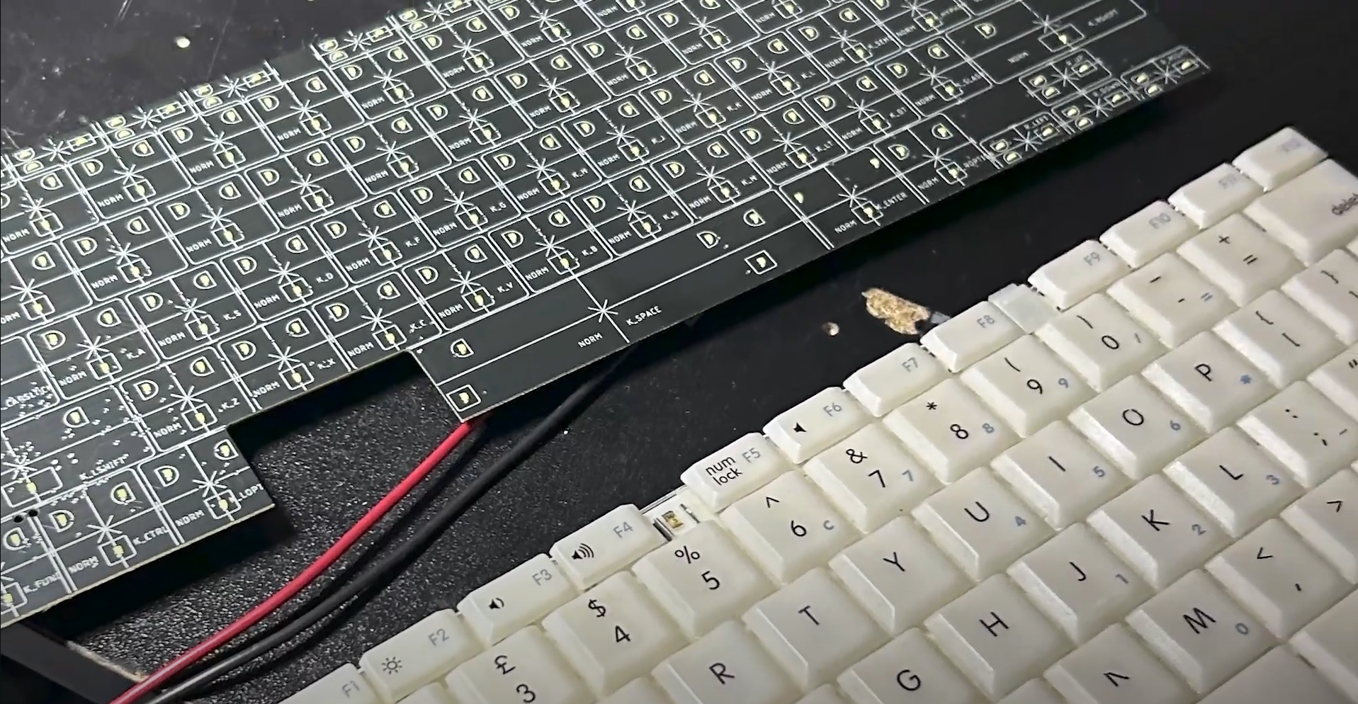

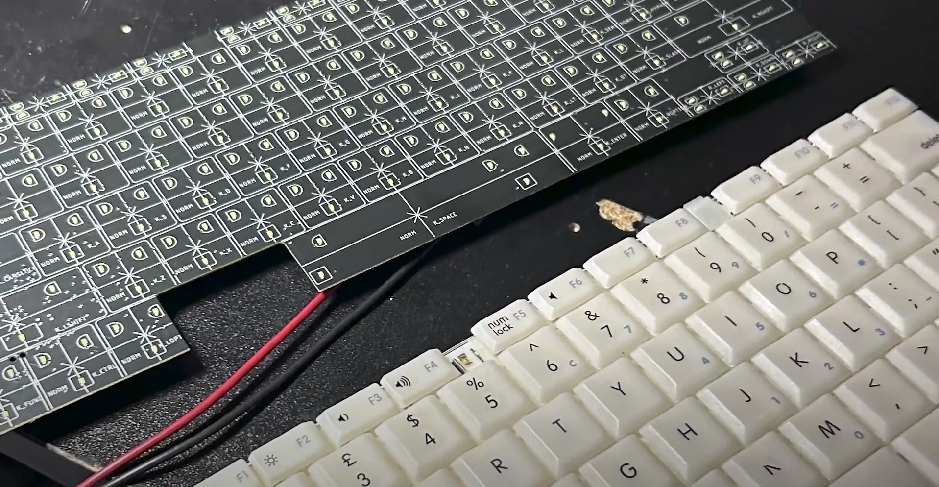

I've been a bit busy, but just received the keyboard lighting PCB I've designed to slot behind the original keyboard. Here it is with some initial test code. YouTube
