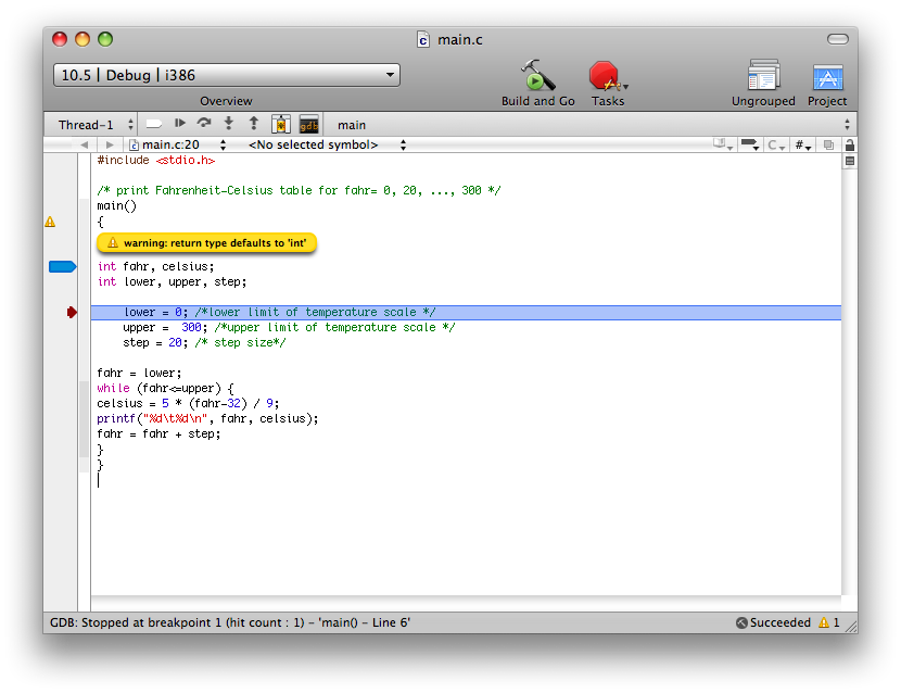

So im reading one of these eBooks for C programming. I have done "hello world' (yes i am a complete beginner) and now im doing this one that prints at a calculation of temperatures - F vs C.
But i keep getting this warning - 'return types defaults to 'int''

for main's signature, use:
Code:
int main(int argc, char *argv[])
rather than
Code:
main()
I don't think we need a debate about what's "most right", but it will be easier for you and anyone that reads your code if you use the signature posted above for main.
-Lee
your main() function should be declared (minimally) as
int main()
Pre-ANSI C allowed main to be declared without a return type, or a return type of void. These days, you declare it as returning an int.
int main()

Edit: Technically it should be
int main(void) or int main(int argc, char *argv[]) they are the only two correct usages according to the standard. Everything else is implementation defined.
