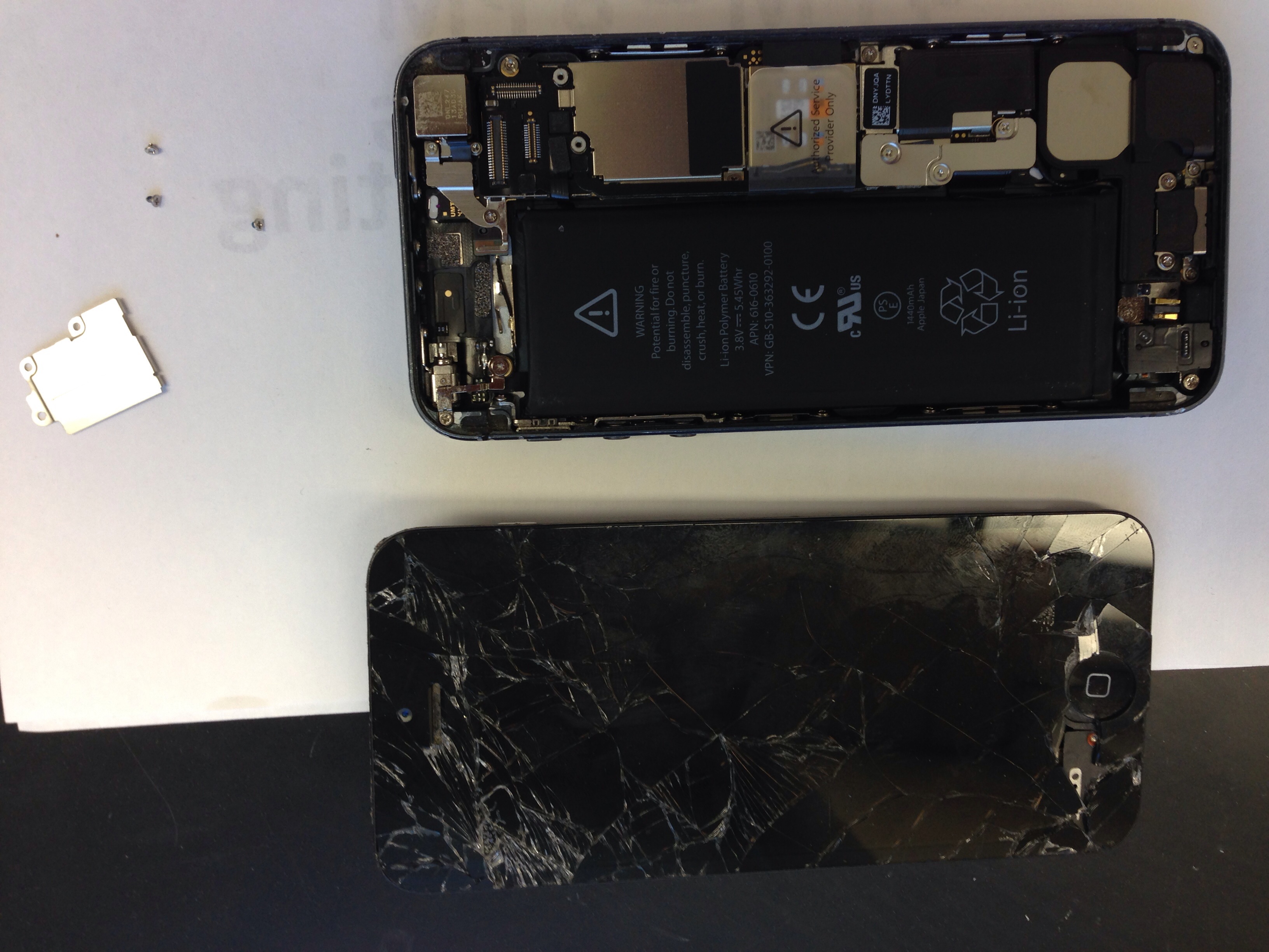

I think it's about the same. Here's a phone I'm currently working with, below, and I already have access to the battery after removing the screen.

So access is the same just front instead of back right? Any other differences?

Yes, that is correct. Once you have the screen off, you have access to the battery and internal connections. There are differences; headphone jack is at the bottom, so the jack is not connected to the volume/silencer flex cable (on the 5, the jack is part of the speaker/bottom mic assembly), which is convenient especially if you do not have to work on these. The screen bezel is not secured to the mid bezel via screws like the 4/4s; there are only two screws at the bottom of the phone which are accessible from the outside of the phone.
