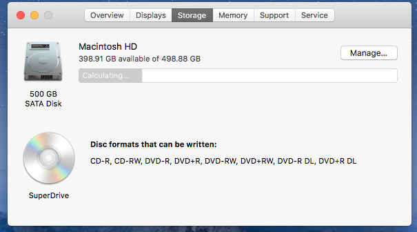

a-m-k
macrumors 65816
Sep 3, 2009
1,448
111
I'm only posting the screen shots because I've noticed one difference between the Macintosh HD readings. I just noticed it a few minutes ago. So, I am guessing the final diagnosis will be the SATA cable. My question, why would the "about this Mac" Storage settings have a numerical reading and the Macintosh HD icon information basically seem like there is nothing on it except the factory settings? I've tried to find SATA cable failure tests, but I can't.
JTToft
macrumors 68040
Apr 27, 2010
3,447
796
Aarhus, Denmark
- There isn't a difference. Notice the three dots in the middle on the icon. It probably hides something akin to "498.88 GB drive; 398.91 GB free".
a-m-k
macrumors 65816
Sep 3, 2009
1,448
111
I was thinking it just dropped the second "8". That's all.
