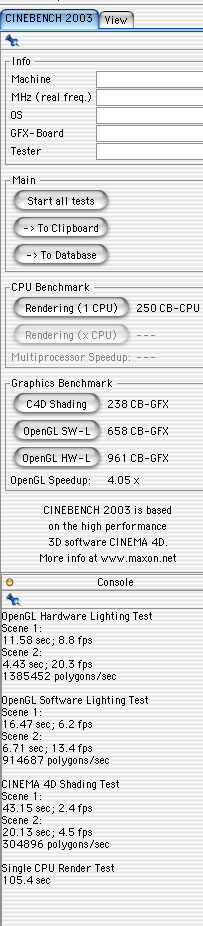

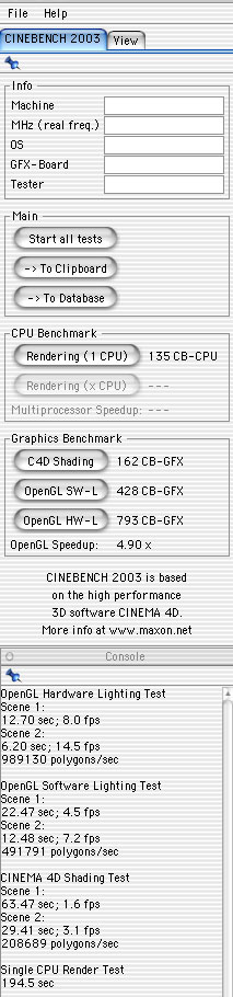

CINEBENCH COMPRO!
Contenders:
20 inch G5 iMac
1.8ghz
1GB Ram
160GB HD
NV 5200 Ultra 64mb
Airport Express
--vs--
15inch Powerbook G4
1.5Ghz
1GB Ram
80GB 5400rpm HD
Radeon 9700 128mb
Airport Express
the iMac destroys it!
Btw avg xbench score for the powerbook with 5400rpm drive is 135, avg for the 20 imac is 162.
I think the iMac is pleanty powerful for con and quasi-prosumer use!

the result of cinebench is that the iMac rendering (CPU) is 85% faster than the 1,5 GHz G4 Powerbook. And that's pretty cool I think.. Even the open GL results are better than the ones from the powerbook. So the imac will have more fps in Unreal than the powerbook...
