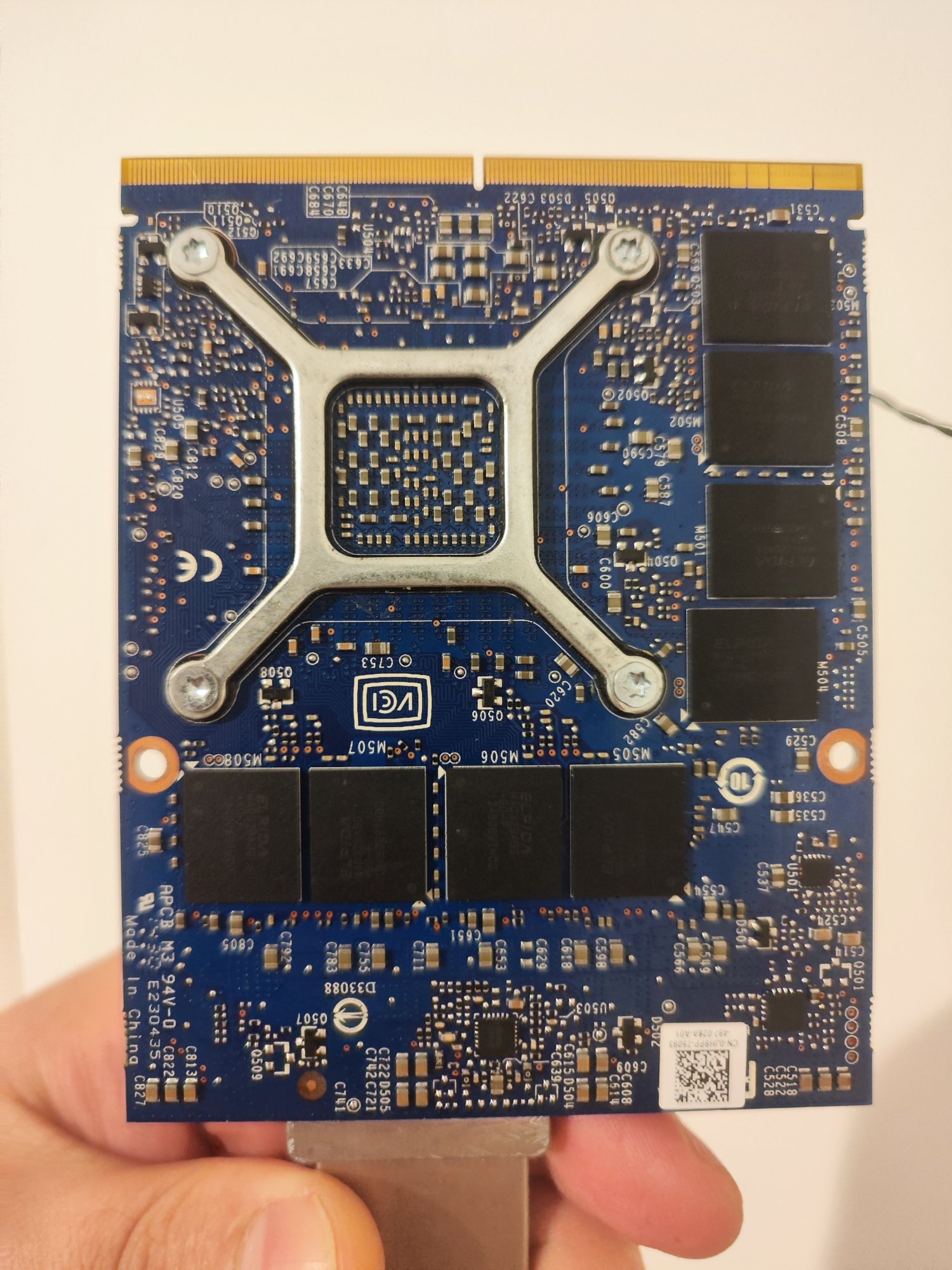

I have an iMac 12.2 2011 A1312 with i7-2600 , 32GB RAM and the AMD 6970m with 2GB. The AMD is thus broken, I bought a GTX880m with 8GB, vbios of Nikey22 is flashed in the GTX. Now to my problem. I put everything together, but the iMac do not start as long as the screen is connected. Only LED 1 is on, the fans spin briefly and that's it. If I unplug the display either the flex video cable or the black power plug next to the video flex, or both, the iMac starts up to LED 3 so fans go and boot sound too.
What is the problem? Can anyone help me would be really grateful. Have also photos and videos falls that is allowed I would show it to you. THANK YOU
Possibilities:
1. Broken (shorted) LVDS slot on the logicboard.
2. Dying card (get shorted circuit when LCD is connected.)
3. Touching part when connecting the LVDS. => Reassemble the MXM card with proper isolation.
Check with an external display to see if it works.
Check with the GRML Linux USB to see if it works.
I use the X Clamp it was allready on this GTX880m. As far i See with my eyes it doesnt Touch anything.
