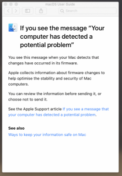

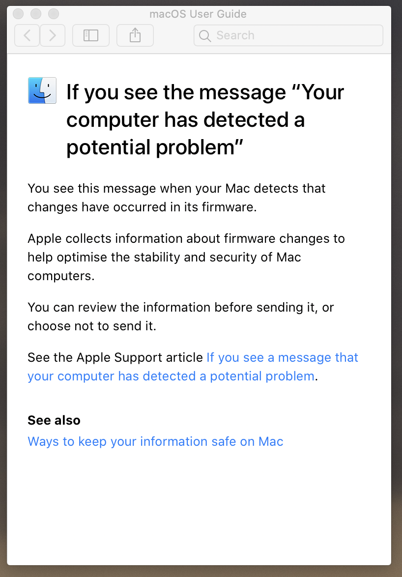

Yesterday I once again have updated my 170.0.0.0.0 iMac from High Sierra to Catalina 10.15.7 (no change in FW version) and today got a message "Your computer has detected a potential problem - click send to Apple..... (screenshot detail attached) I never got this message when I last tried back in March. Hope it means someone is taking note.
that means you have a problem with your motherboard and it needs to be replaced
