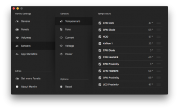

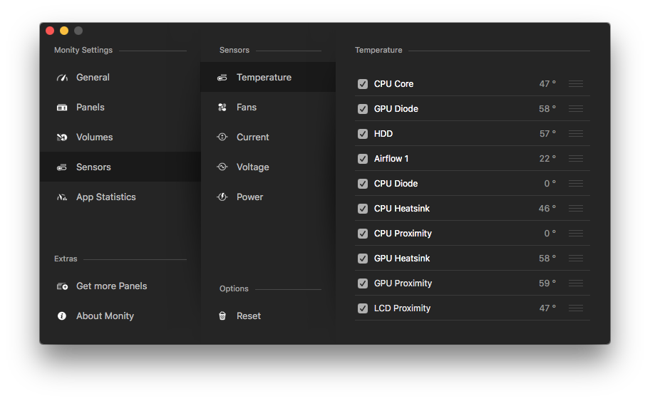

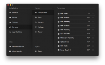

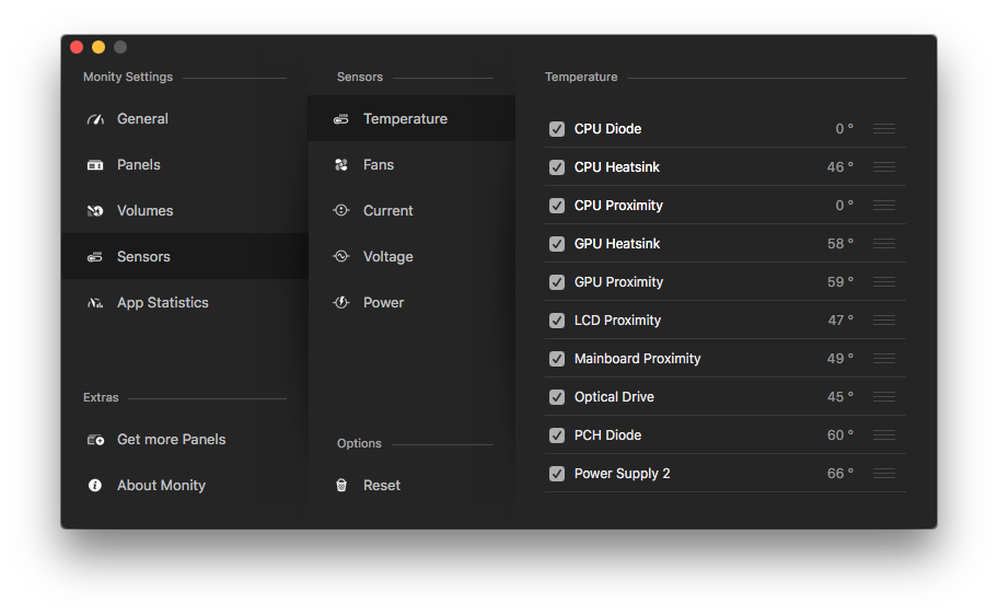

That said, it has returned with a vengeance. The Apple Store team ran a diagnostic and were unhelpful. Didn't tell me anything that I didn't know. I bumped up my fan speed to 1200rpm for ODD, HDD, and CPU just for laughs.
The temperatures seem fine but attaching here for reference.
I swapped out the RAM I bought from OWC just to see if that was the issue.
I'm left to believe it's Graphics Card related.
