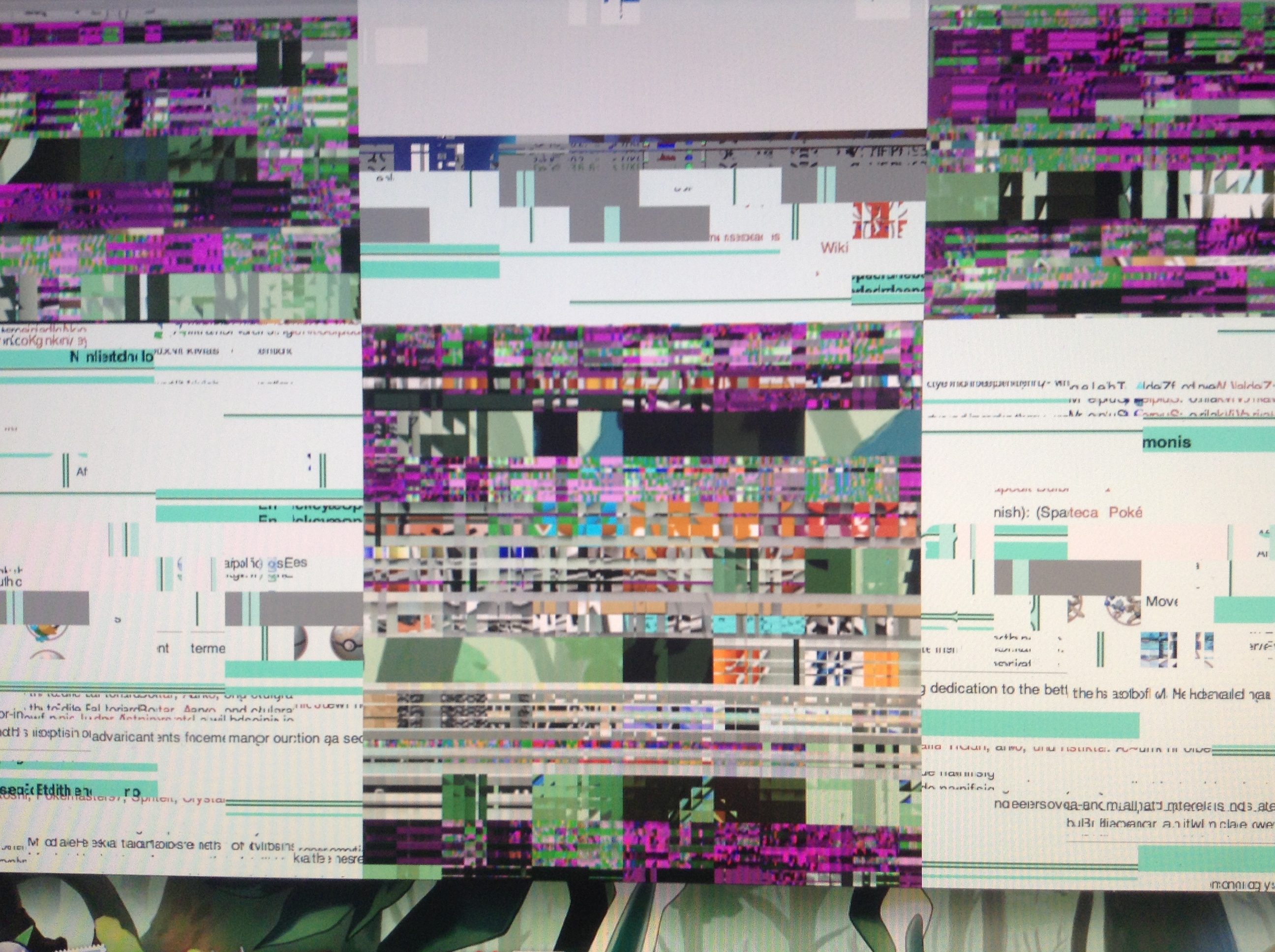

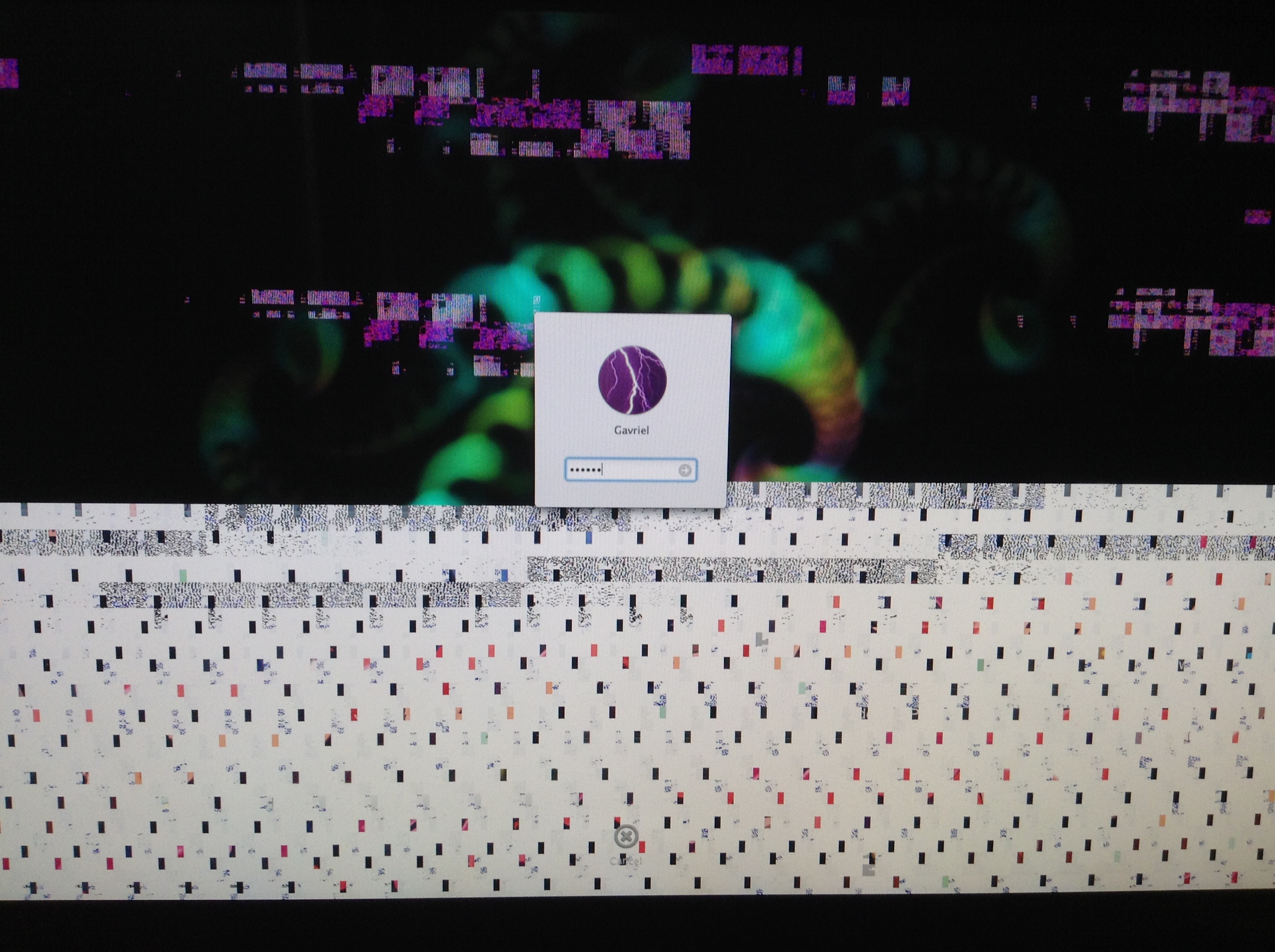

I was editing my video in Final Cut Pro X, then suddenly, a bunch of lines and blocks and shapes appeared on my screen (graphical glitches). This happened to me back in April this year, I turned the LCD smoothing off, and never had this problem again, until today. I first tried to just restart the computer and ignore the problem, but it came back. I highly suspect that this is still a problem in OS X Mavericks. Can anyone confirm this or tell me what is the problem? If it's a software issue, I will downgrade to Snow Leopard.
You could post a picture or a link to some video of it, but I'd much sooner suspect a failing GPU rather than software with graphical glitches like random lines, blocks and/or freezing.

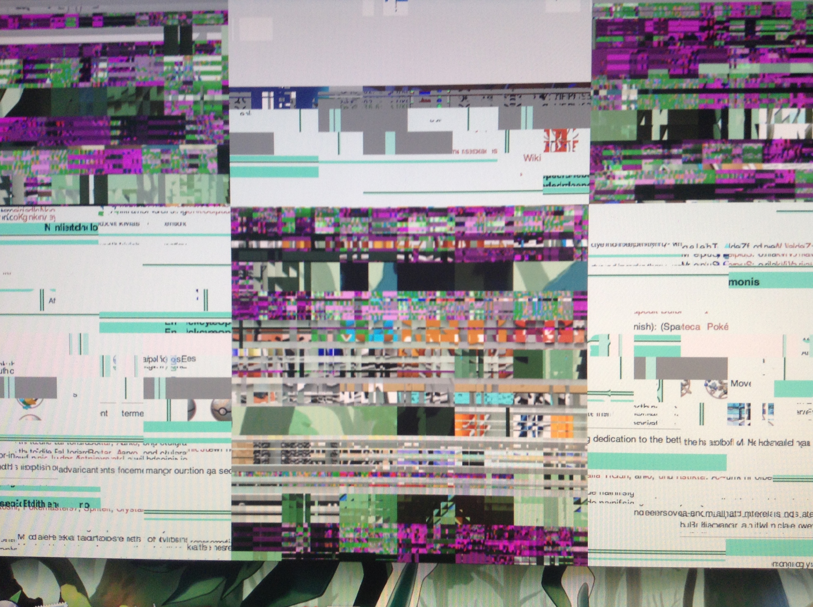

Well, here is a picture of how it looked like when I had the issue in April, currently, it's still similar. Let's suppose that the issue is the graphic card. What can I do in this case? Can I replace the graphic card or is it soldered/fused to the logic board? I mean, I don't have much money to spend on repairing the computer.

That does look a lot like a failing GPU. They can be replaced without replacing the whole logicboard in that model iMac. But they can be costly to replace.
Does it just require soldering or does it need more complicated processes? Also, where can I buy that graphic chip, and which ones work with my iMac model?
The hardest part is opening and removing the logicboard. The GPU is on a video card and the whole card is replaced. You must use one from another iMac of the same or very similar model.
Yeah, that most definitely looks like a GPU on its death bed.
As Intell mentioned, replacement of the GPU itself is possible if you can find the part. Here is a guide from iFixit.
Some have also reported success by doing a reflow, basically putting the GPU in an oven at 200° for about 8 minutes to re-solder all the points on the board.
It's certainly worth a try before investing in a replacement part.
Just a quick note, I have a 21.5" model, I'm not sure if the graphic card replacement is only for the 27" model. And it's expensive. I'm gonna try to cook the graphic card, see if it works.

Anyway, your screen captures make me suggest that both the GPU and the VRAM has protential problem. Replace the whole graphic card may be the only solution.
