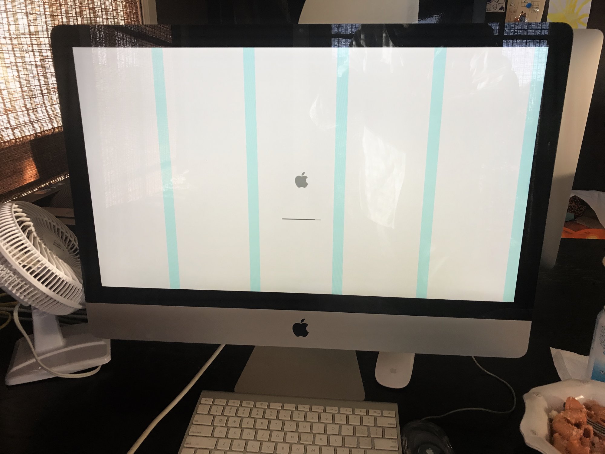

Many years ago I gave my daughter a iMac 27". Since that time it has had the HD replaced by Apple service. Yesterday when I was visiting I noticed her IMac had a progress screen going with nothing moving. When I forced a restart the apple symbol came up but the it stalled again. Then I restarted in recovery mode and used my Disk Warrior USB to check DW reported disk errors and high heat and could not rebuild the directory. When the screen is on it has the apple logo and large vertical bars on both sides. Question is this just a hard drive failure or did leaving the mac on for days trying to load kill the graphics card/display? Is this worth fixing?
It is typical for the GPUs to fail on the Late 2009 to Mid 2011 iMacs. Symptoms usually include stalls on boot up when the bar is about 2/3 the way filled, and of course graphical artifacts and lines.
The cause is debated, but many believe that there is not adaqaute cooling for the HDD and the HDD just gets so hot. I suspect as the HDD ages, the heat would become more intense.
I once pulled a failing HDD from a Mid 2011 iMac, and attempted to operate it externally using adapters, and that drive got so hot that I think it would have left burns on my skin if I would have held it for more than a few seconds.
Many people replace the HDD with a SSD, as it is relatively easy with that model, but if your GPU is already showing artifacts, it might be too late for a intervention with a SSD.

If you are seeing artifacts on the screen, then the GPU is most likely failing.

Could you take a picture of what the screen looks like with the artifacts?
If by any chance the GPU is still hanging on, you can test to see if the HDD is the culprit by booting from an external drive.

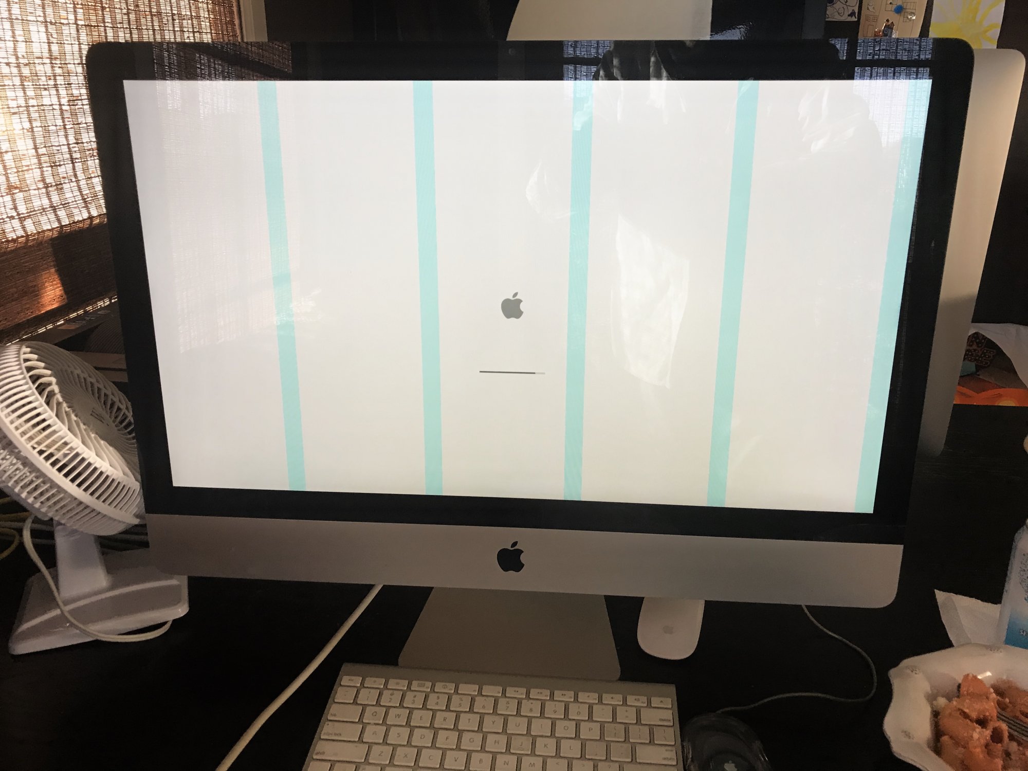

freezes when almost loaded. see picture. it may be just the GPU.

Per the pic in post 17 above, it's almost certainly the GPU.
