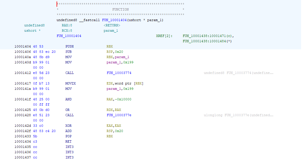

The code i found is in the Module PowerMgmtDxe. (GUID: F7731B4C-58A2-4DF4-8980-5645D39ECE58)

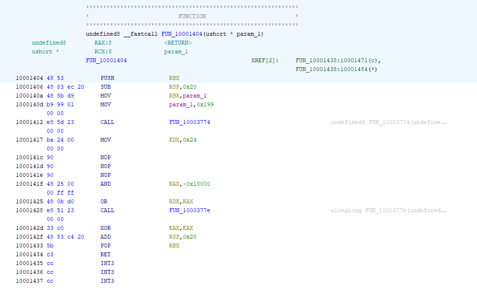

0x199 is IA32_PERF_CTL and handles multiplier. ChatGPT told me to change this to a constant value that will override the default value. This is probably very useful if you have a unlocked CPU like the i7-875K

The resulting code that will set multiplier to 36 is: (0x24 is Hex for 36 and can be replaced with any number. 0x28=40x 0x2A=42x etc)
