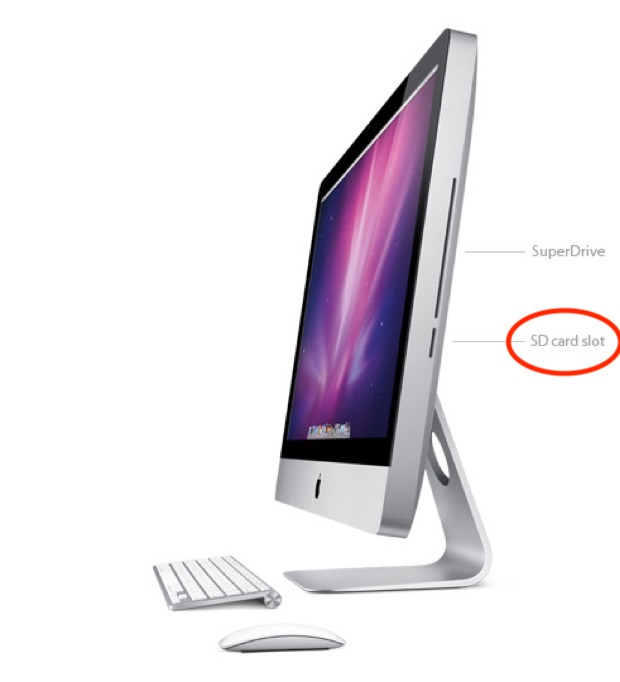

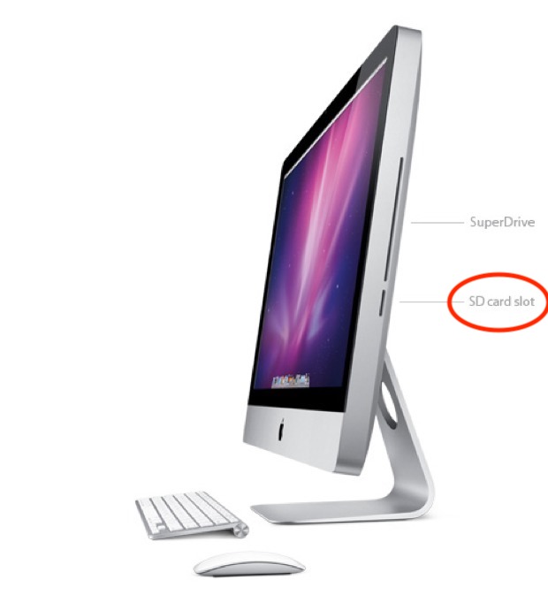

The OP is referring to the SDXC card slot. On the Mid 2011 iMacs, it was located on the side of the iMac, which was nice (they are inconveniently located on the back on Late 2012+ iMacs and the iMac Pro), but also located dangerously close to the internal optical disk drive:
