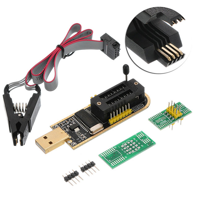

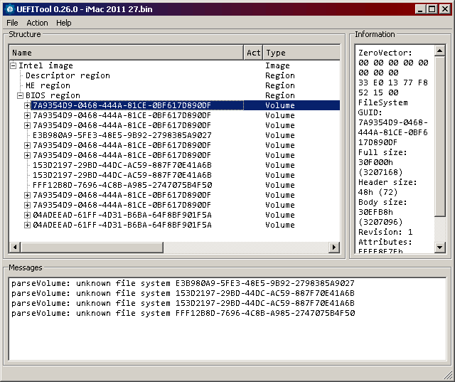

So it could be a defective Bootrom. This mostly happens running an systemupdate of OSX including a firmwarupdate which failed. You need a CH341A programmer to read the Bootrom and verify it using UEFITool.

Thanks! I have ordered mine. It should be here tomorrow.

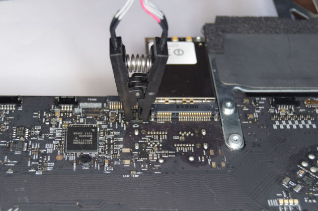

I was able to read the bootrom, how can I verify if it is corrupt or not?
