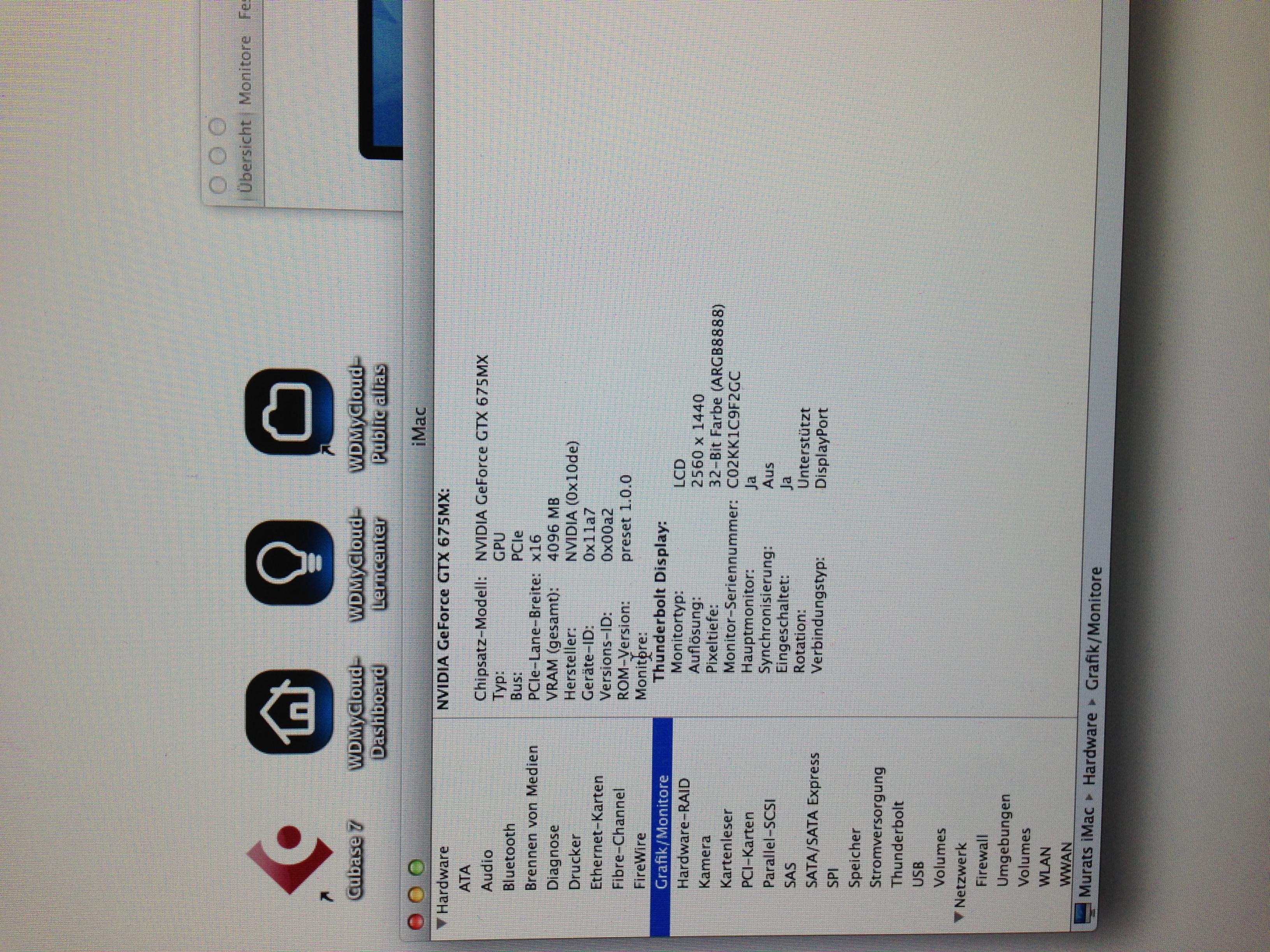

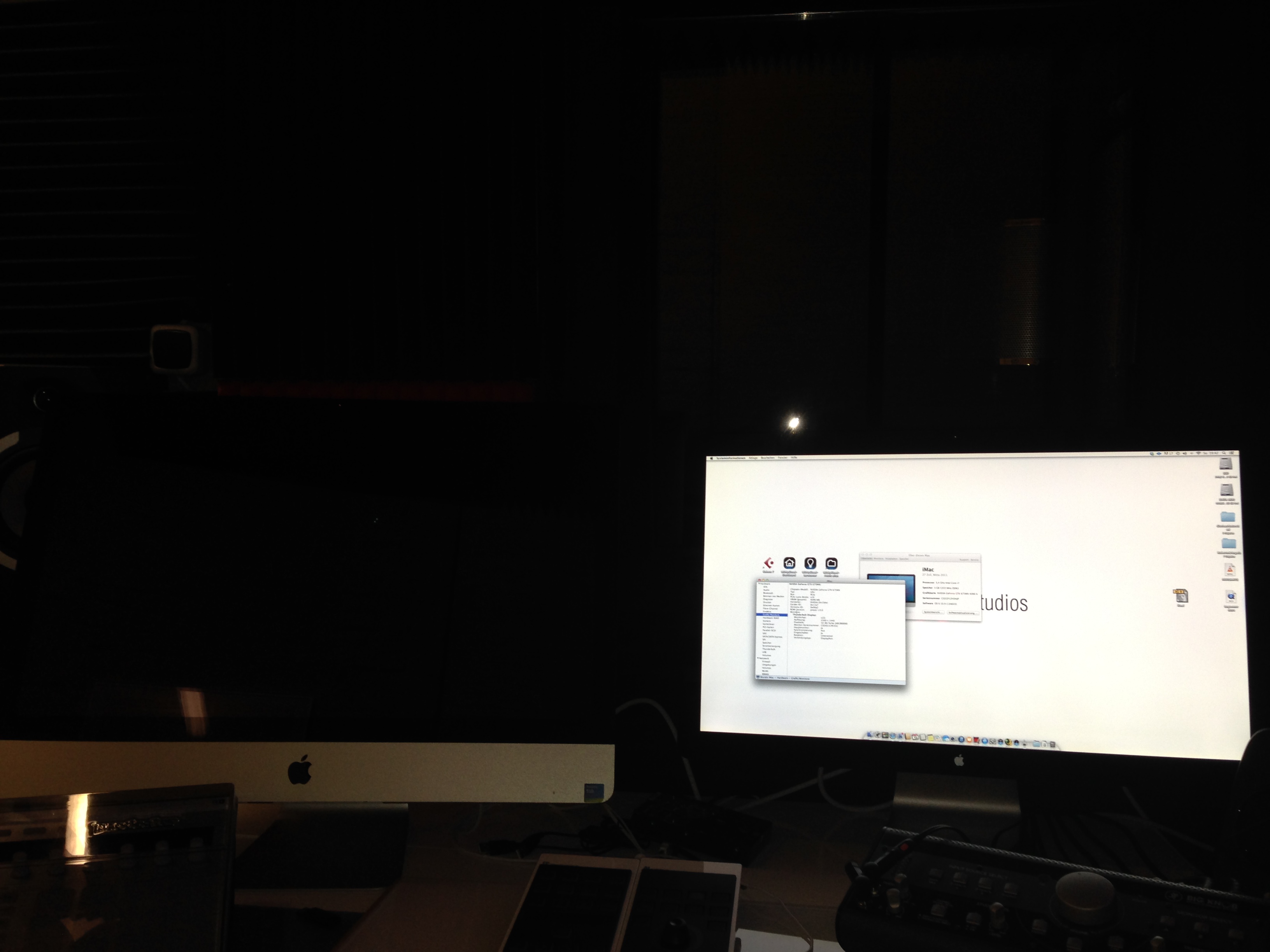

So here are some Pics from my Imac...

You should probably hide your serial number - it's visible in those photos.
It also sounds like the 675MX needs a custom firmware to make it compatible with the iMac.
I assume all the internal cables have been reconnected? The iMac's internal display is run over a DisplayPort connection - this may not be visible to the new GPU if it's a port on the logic board without a specific Mac firmware.
hmmm.but in the new imacs there are some which provide this card so there must be a firmware..where can i get this...?
People have asked users that have the 675/680 GPUs to use the firmware dump tool to extract it so that it can be used to flash other cards, but as far as I know this has been unsuccessful with the late 2012 iMac for some reason.
Macvidcards might have more information.
I believe the 2011 iMacs used a standard LVDS connection and the 2012 and later switched to an internal MiniDisplayPort connection. They may be physically identical connectors but they used different protocols. Either that, or you missed a connection or damaged one. The two suspects would be the main data cable or the backlight cable, though if it were the latter the machine would behave as if the internal display was attached.
