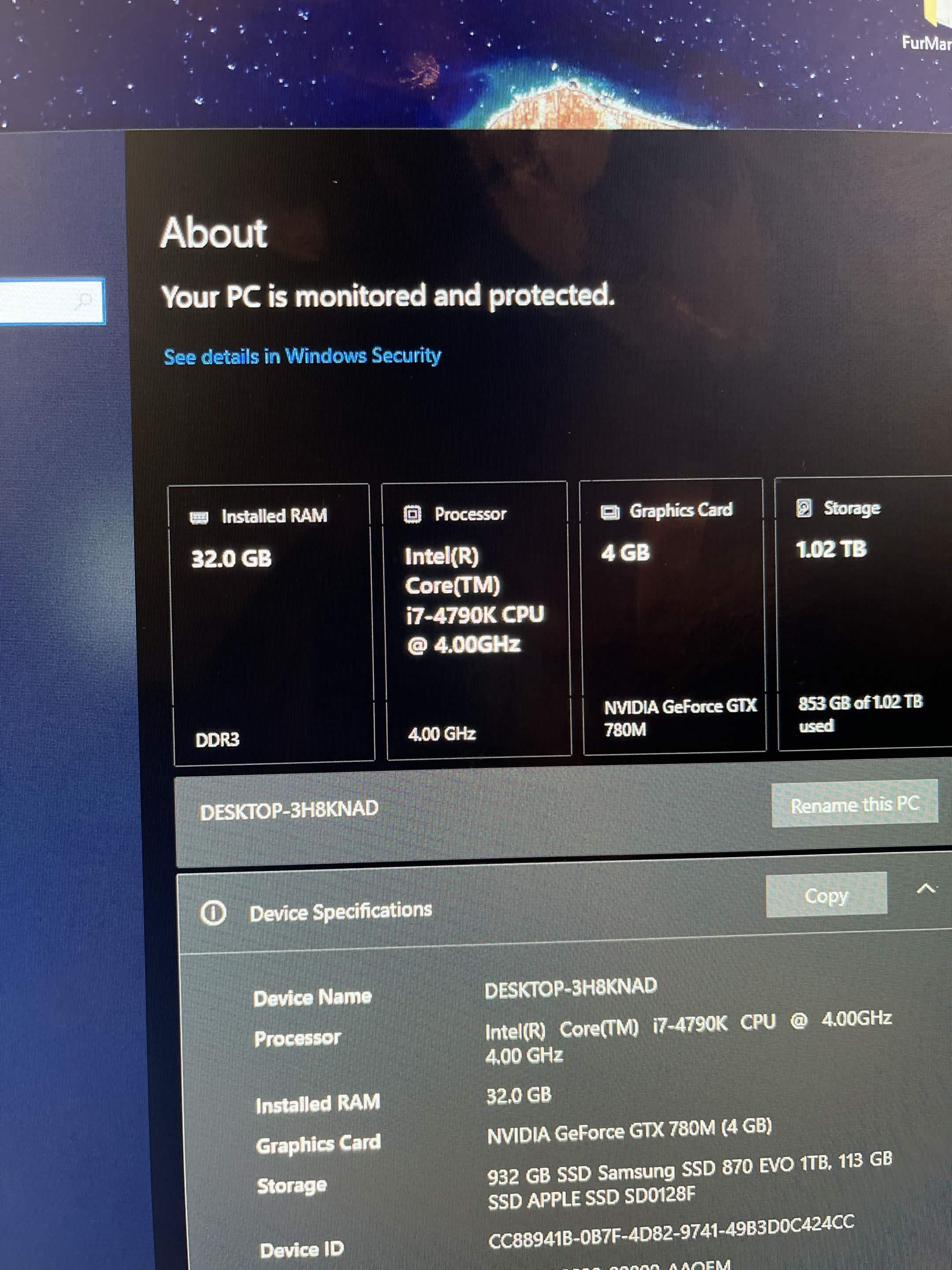

Dosdude has done a video of putting a 3rd gen cpu in a 2nd gen macbook, and he had to use a custom bios for it to work...
i am currently working on a 2013 to see if i can backport 4790k support,
although i gotta admit most of it will be with help of AI, i am more of a hardware modding guy than soft/firmware..
i got a 780m variant here, and might do a 8gb vram swap on it later,
but 2013 and 2014 are the same z87 platform and such, it's just smc/firmware lockout... so i hope i can fix it.. i will not be able to just port a full bios like Dosdude1 did 😂😅

there ya go, custom bios and we got a 4790k on the 2013,

Would you like to describe your changes to the Apple EFI in all details?
Ngl i ran it trough a local AI, i fed it schematics + extracted bios files and instructed it specifically what to do to it,
took over an hour but it booted first try,
but it is not 100% working yet. powerlimit0 triggers too early, but with throttlestop you can disable the powerlimit and test,
i will still see if i can fix that issue, along with unlocking overclocking, apparantly apple specifically writes a disable MSR before it continues boot,
buut sadly had an accident and now my 780m subjet no longer boots...
so will continue on with my 775 and 755 model (i can just transplant the vram+780m to the 775 and it should work tbh)
