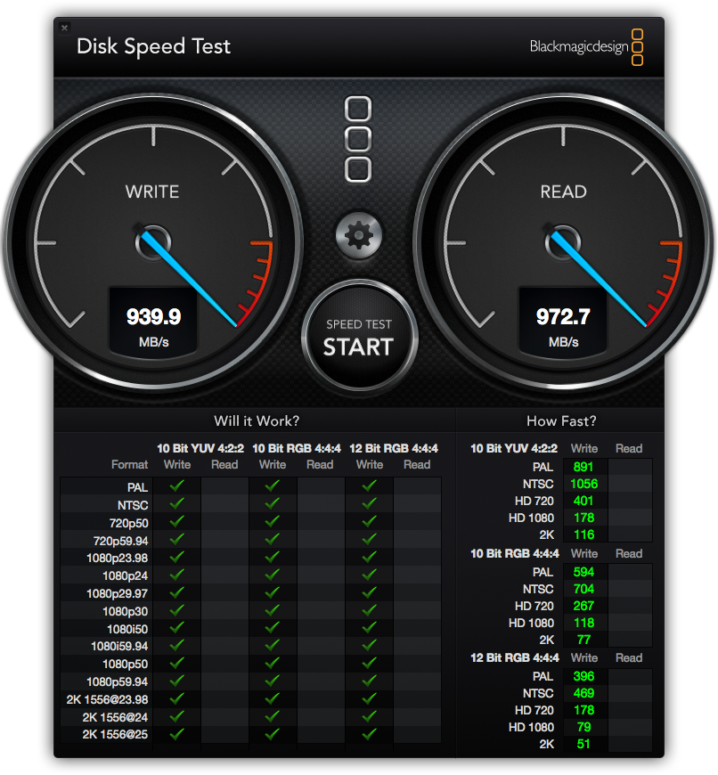

If you add 2 units of SSD into your iMac and make it RAID0 setup, you'll feel the the beast. 🙂
