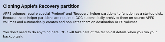

Have done some reading on V5.15 of CCC - it suggests (I think) that since APFS CCC now takes care of the Recovery Partition? Am I reading this right?

CCC will clone a "fusion" drive to a non-fusion drive, no problems.
It can even clone APFS to HFS+, no problems.
So... clone the fusion drive to a backup, it will be fine, a recovery partition should be created, too.
Remember -- once you remove "one side" of the internal fusion drive, the data is lost forever and your only "pathway back" is to restore from the backup.
