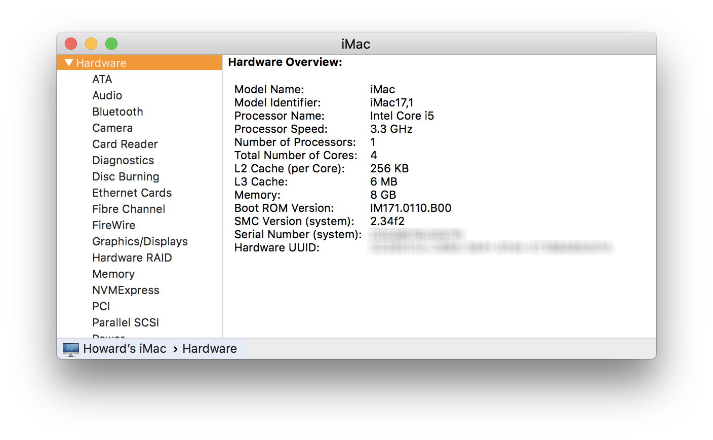

I think this is your iMac, however, it certainly sounds like the "fix" here isn't working for you -
