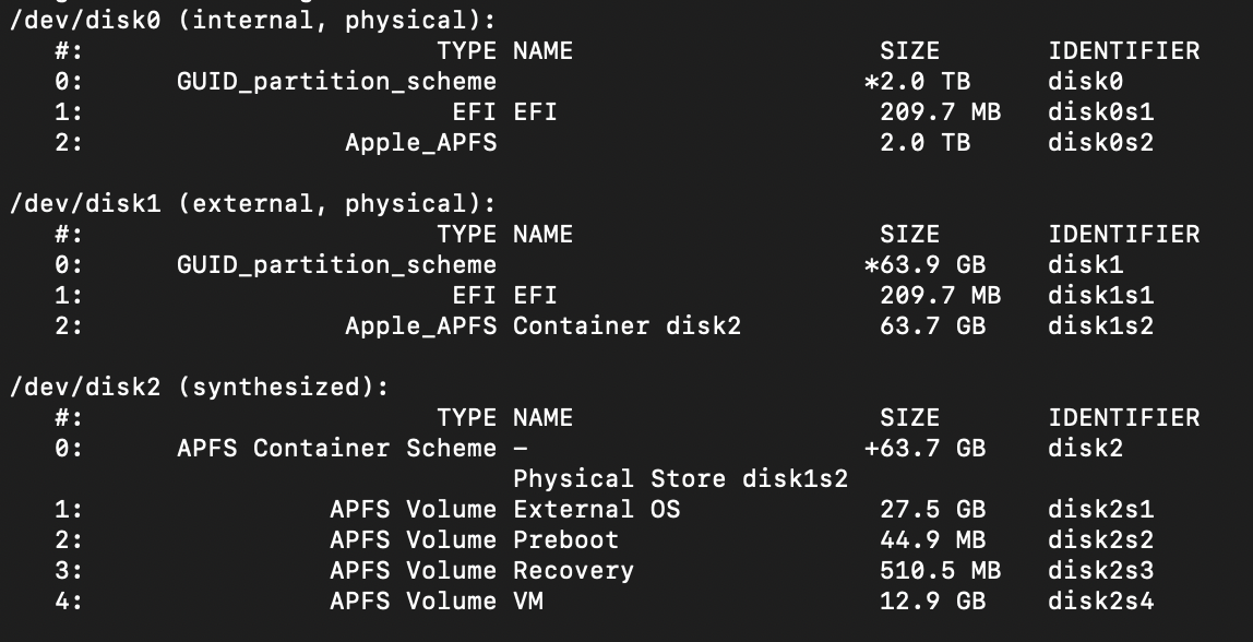

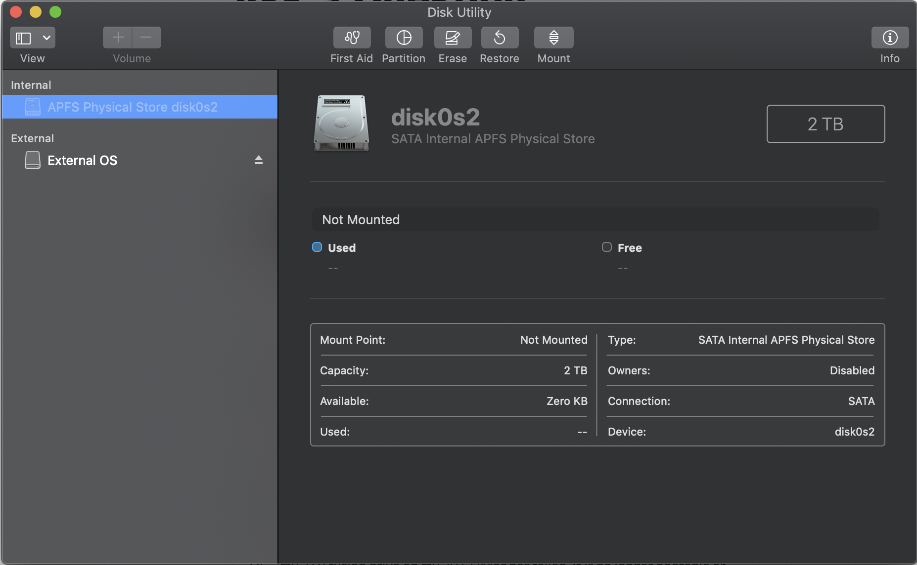

I’ve booted into a USB drive for now. The old fusion drive shows as ‘APFS Physical Store’ but can’t be mounted (see attached screen shot). First aid returns:
Running First Aid on “” (disk0s2)
An internal error has occurred.
Operation failed…

OK thank you -- so am I understanding correctly that the above is indicative that the HDD failed and the SSD is still good? I have just searched all day and couldn't find anyone with the same issue; lots of split drives, etc. but nothing with the behavior I have above in Disk Util
