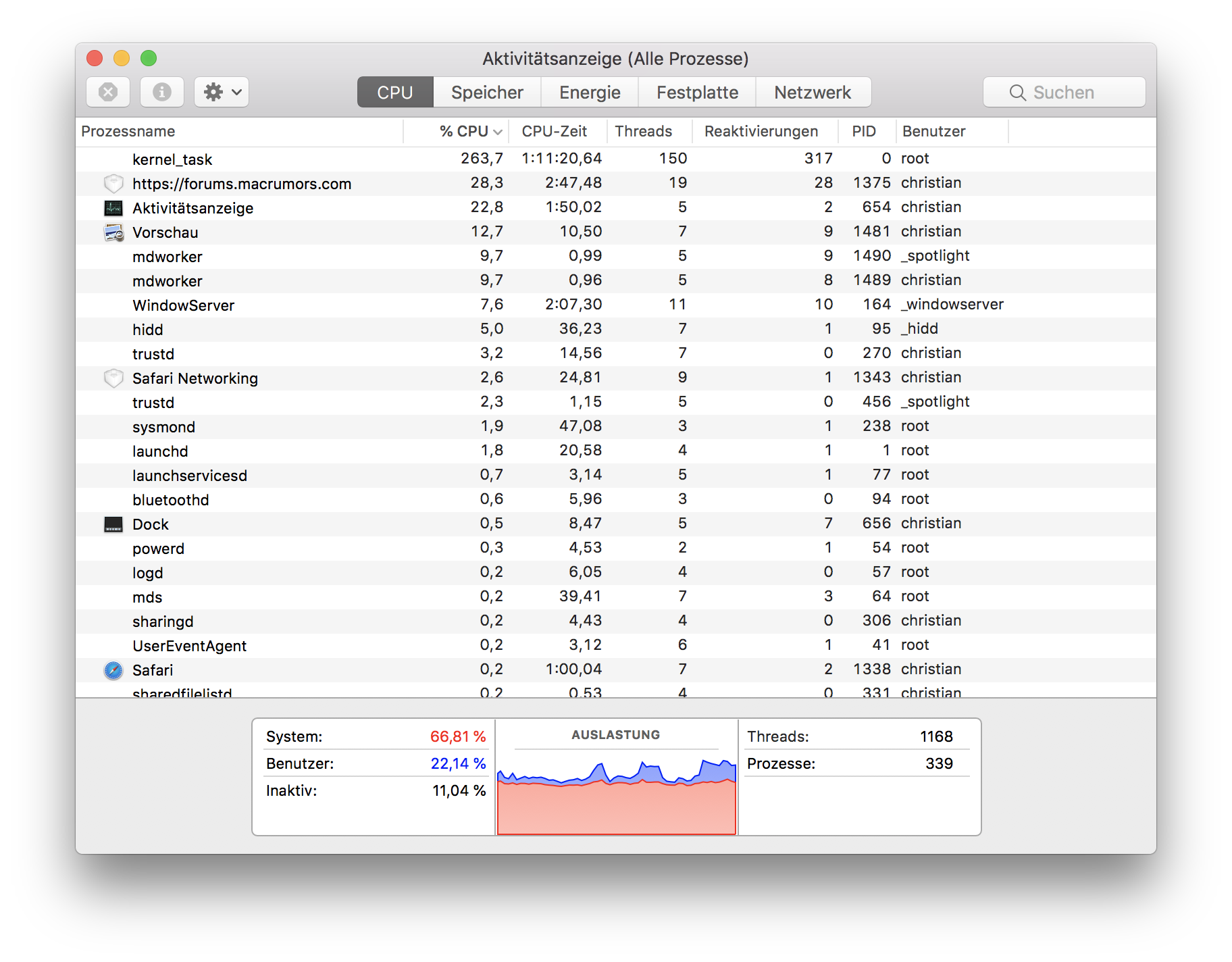

yesterday I received a base iMac 27 with i5 3.4. After 30 minutes of installing some apps, the fan got really loud and the cpu usage was high. I thought it might be related to the installations.

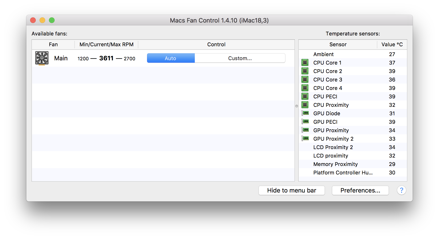

But today the same. I opened Safari to download Mac Fan Controll and it got really loud again with a constant CPU usage above 60%.
According to Macs Fan Control the main fan has currently 3600 RPM (from max 2700?!😕). The temperatures are also really normal.
Even the graphics don't feel fluid when this happens.
Can someone help me what might be the problem?

That kernel task looks like the culprit, obviously. I assume you have rebooted, and know all the programs that are autoloading on startup? And you're on the current version of High Sierra?
Yes I rebooted and turned it off but the fan and the high cpu was still the same.
Autoloading shouldn’t be a problem, I only installed some apps I use on my MacBook like Affinity and WhatsApp from the Mac App Store but I didn’t use any of them.
Rebooting restarts the kernel, so if rebooting doesn't solve the problem you have an issue. It could be a kernel extension, like something connected to third party software or a hardware driver. You may try restarting in safe mode, which does not load any kernel extensions, and see if the problem persists.

LOL.. looks like the exact same problem. My 2016 15” MacBook Pro had the same problem. I brought my mac to apple store and then we found out it’s related to a software. Just delete “macs fan control”, then your mac will turn to normal. It leds to this problem. Somehow it makes your mac think the cpu is under pressure and use kernel task to throttle and cool it. However, in reality everything works fine. I don’t use that program anymore.

I installed Macs Fan Control on the second day, after the first CPU and fan problems to check if the fan is on 100% or the temperature is too high.
On the other hand I use Macs Fan Control daily on my MacBook Pro 2017 because it gets unusable hot in my office in summer before the fans turn on. And I never had any issues with it on my MacBook for years.
But I could deinstall Macs Fan Control and try to reset SMC and NVRAM.

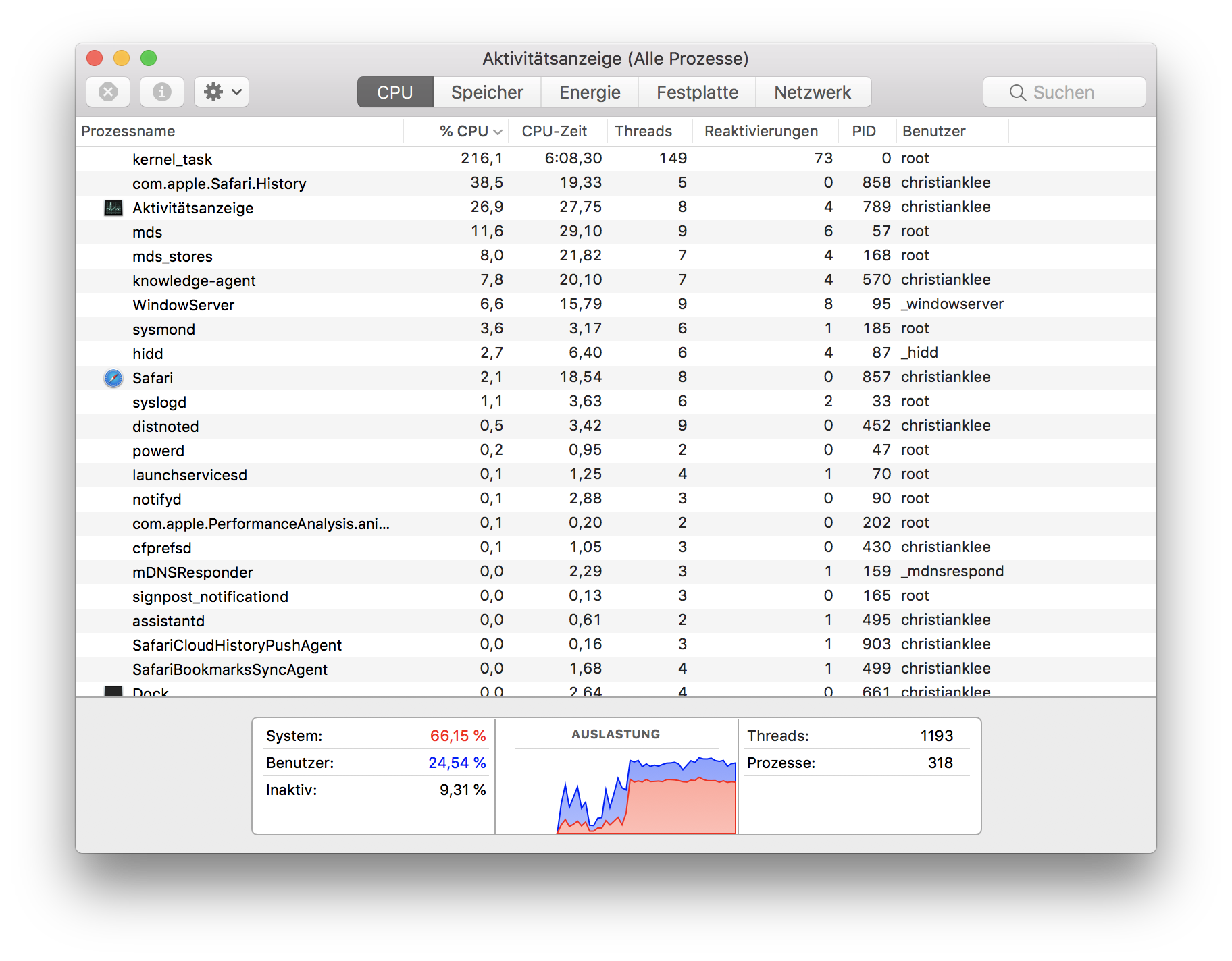

I just made a complete reset and reinstall and ran the diagnostic with the same SMC error. Then I unplugged the power cable to reset the SMC. No errors in diagnostic. So I thought, problem solved and followed the setup.
5 minutes after the fresh installation, the same thing happened again (screenshot).
So now I have to reset it again and sent it back🙁
I hope they will accept the error, because in the first diagnostic with reseted SMC it will be fine again for a moment...

Like I said above, take it back, the SMC is not right. You're just going to be battling windmills with that machine. Get a replacement. 😉
