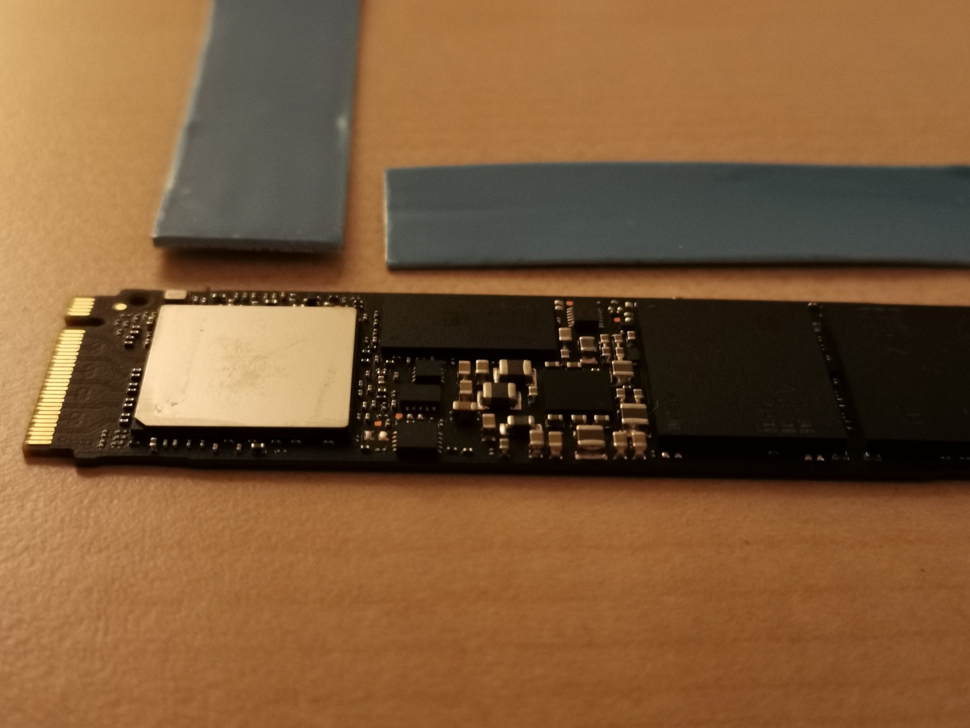

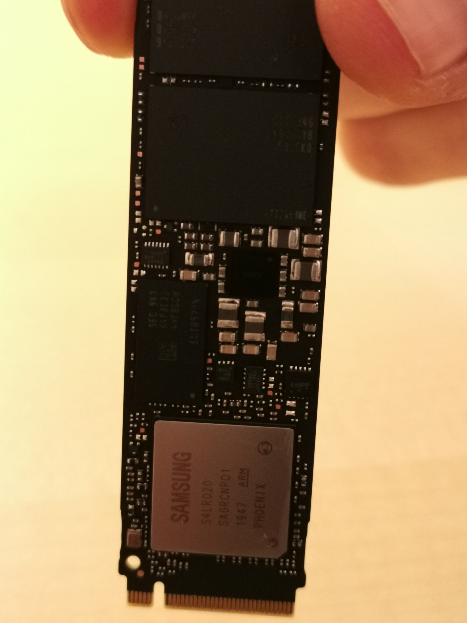

It appears that the Phoenix Controller chip is sitting lower on the drive than the V-NAND Chips, wouldn't it be better to cut a square piece of the 1mm thermal Pad and apply it to the Controller and cover the V-NAND chips with 0.5mm so the Heatsink fits nice and flat (level) on top? See attached images...

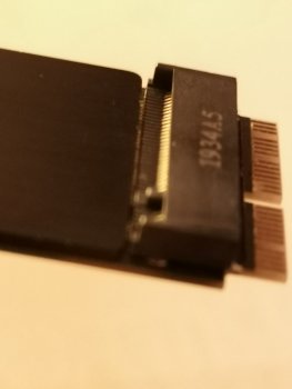

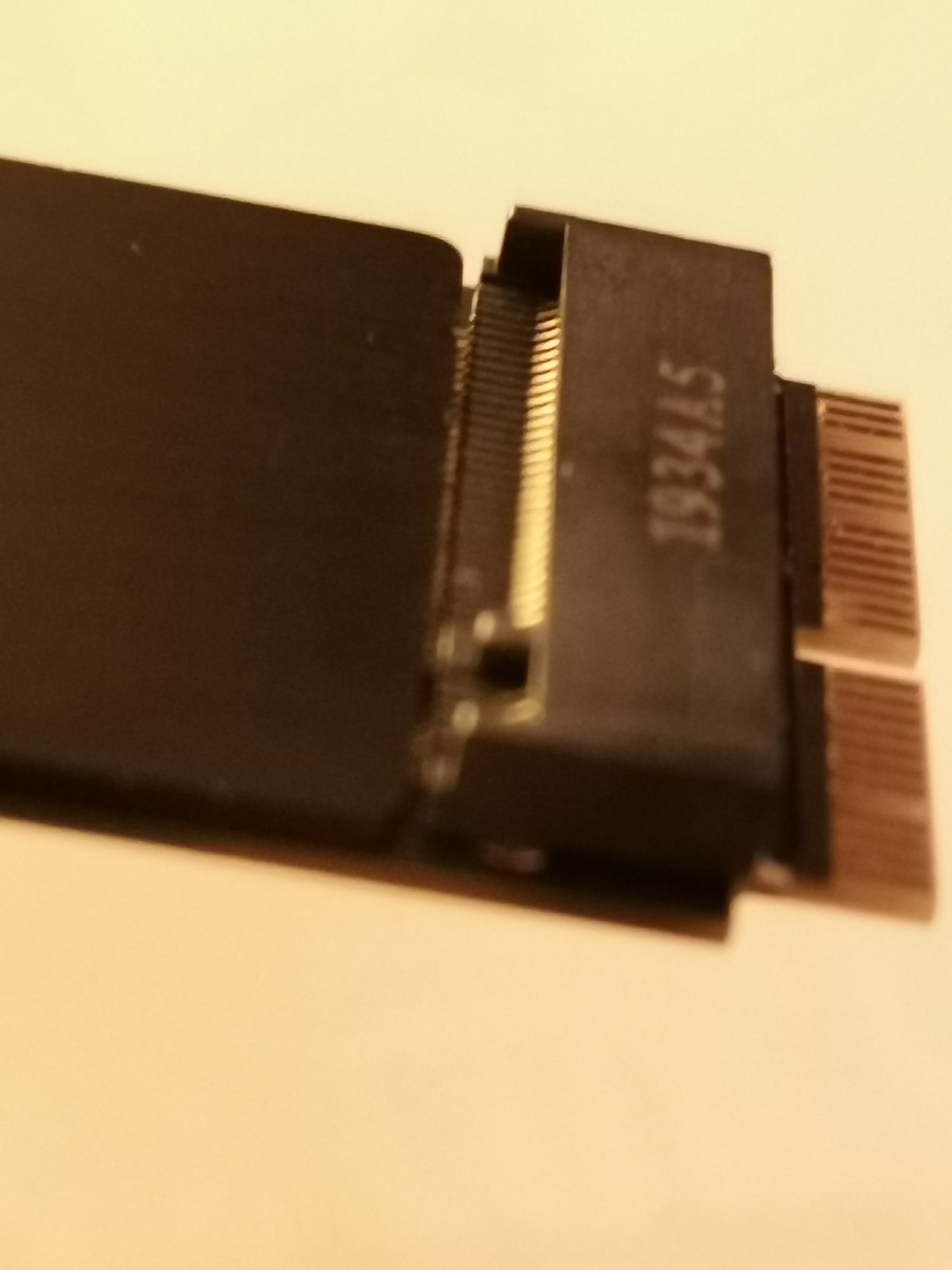

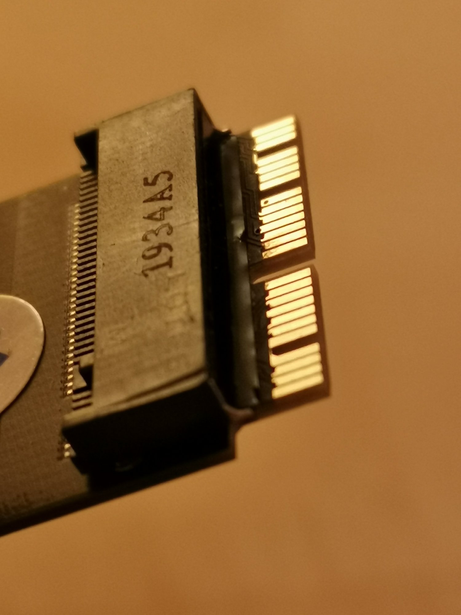

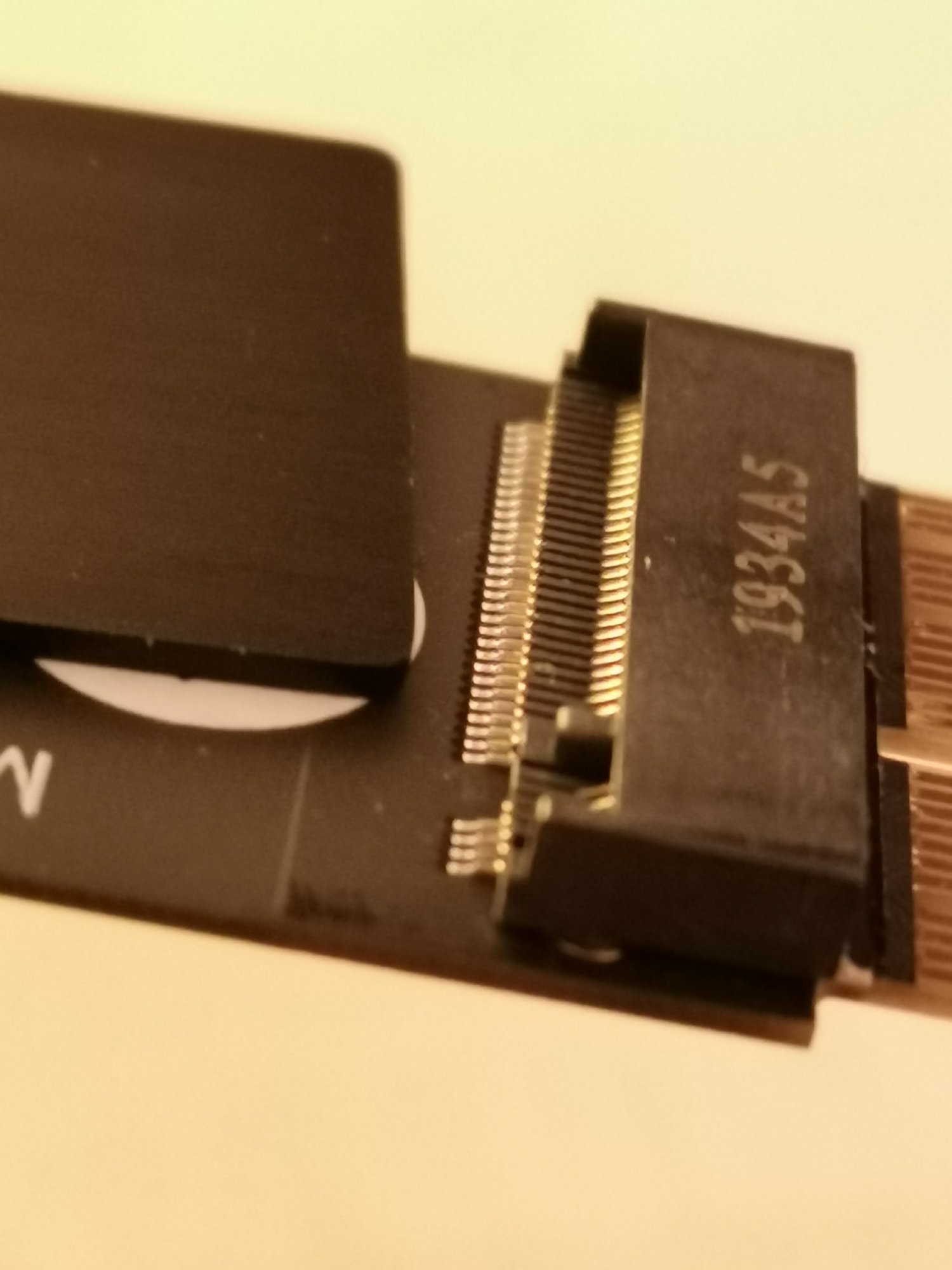

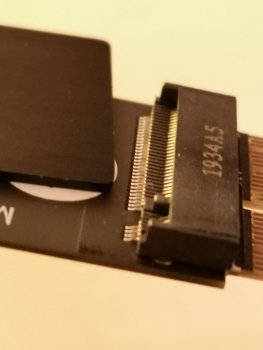

Also the Sintech adaptor has got some sort of tape on the electrical pins that were exposed on previous versions but I am worried about how close the bottom heatsink is to some other pins that reside on the other side where the SSD fits into the adaptor, see attached images, should I cover that part with some Kapton Tape and maybe file down the screw hole on the bottom heatsink so I can pull it out a little further.

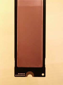

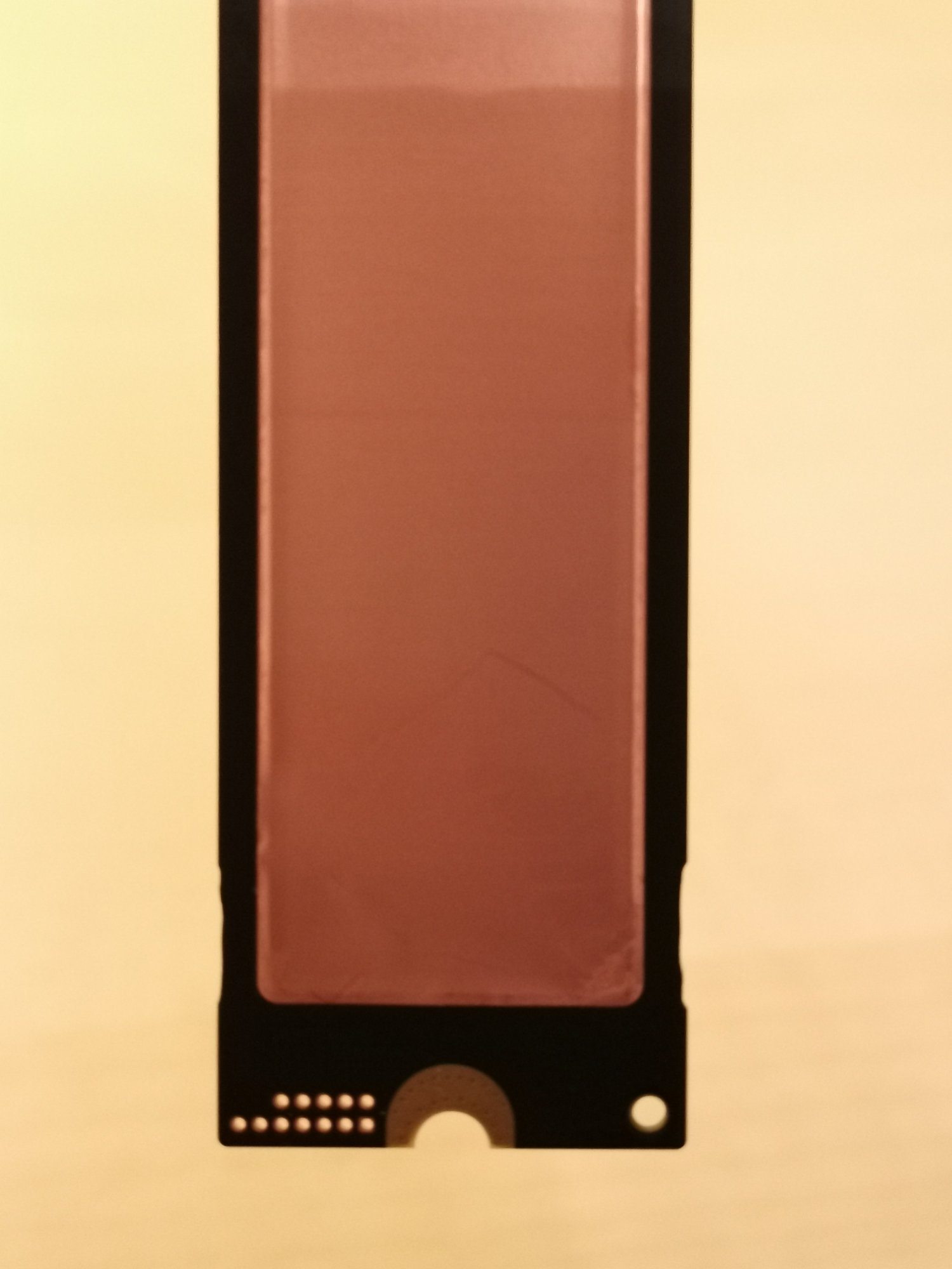

Note: under the SSD nvme m.2 there was a copper strip which I have left on, but on the top part the sticker doesn't appear to have any copper in it or underneath it so I removed it and hope that the thermal pads and heatsink will be sufficient enough.
