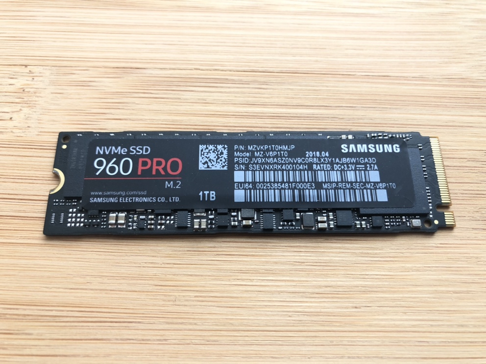

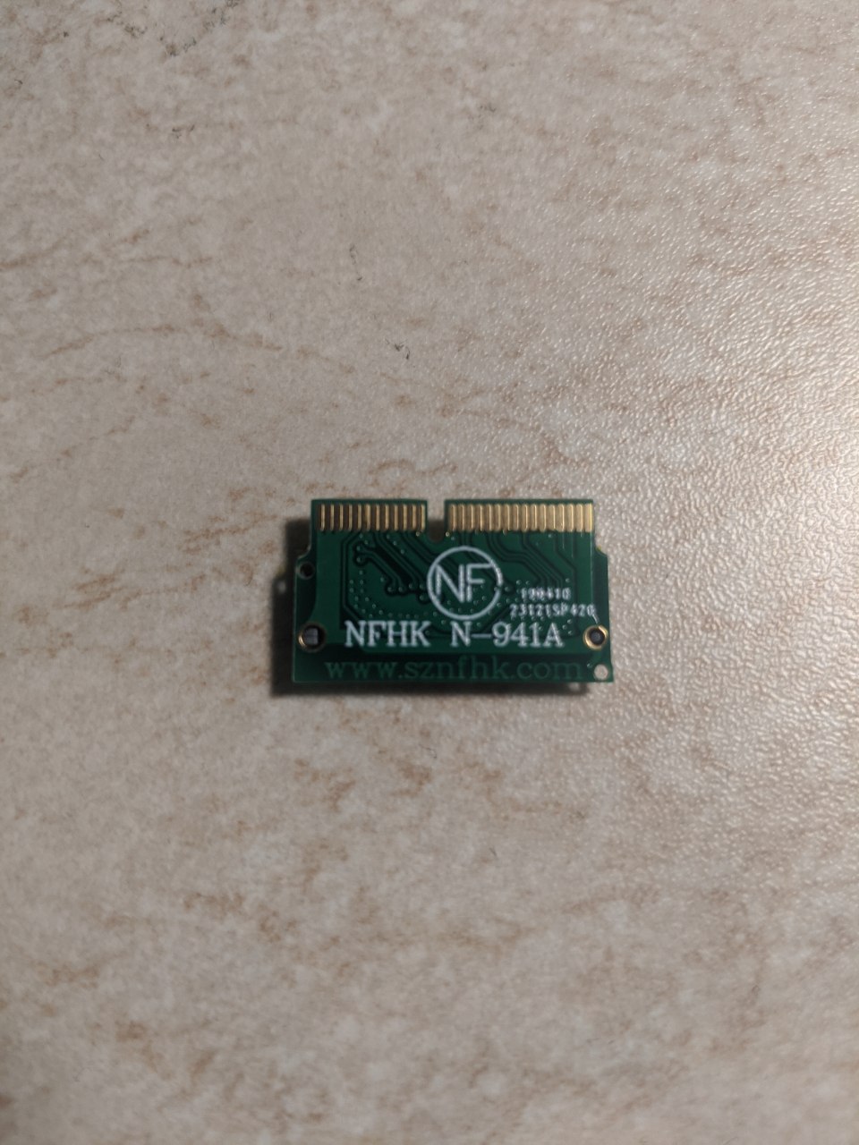

Searching about 2 month about breaking fusion drive and change original apple ssd to nvme2 samsung.
Not enough information in internet, youtube.
So, operation was completed successfully - 2 days test - no problems at all.
Hope it will help some one who searching info
As i have understood samsung 960 pro is similar to fabric apple blade ssd
-Why Samsung 960 pro, when there is newer 970 - because of temperature.
32C on 960 pro vs up to 80C on 970 version
Used equipment

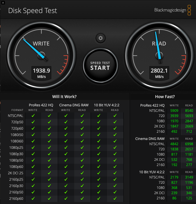

Hey what are your reads/writes on the Samsung, and which model? Is Apple still bottlenecking the stick with 2-lanes?

I have updated first post.
2 weeks tets - everything is great. Catalina 15.2, no sleep issues
A little bit slower than new 970, but no problems with overheating and firmware issues
