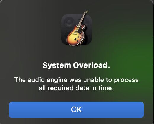

Garageband freezes all the time and always has.
I can give more details if required but any help would be great.
Cheers for advice
Jimmy
I remember when I first bought it I had Apple Care and they tweaked around with it over the phone. Not sure whether anything changed if it did it didnt change for good, (I never used it much until I retired last year).
Chat gpt sends me round in circles and tries to get me to 'freeze tracks' which you can't do or 'GarageBand > Preferences > Audio/MIDI, increase the Buffer Size' which you also can't do.
Then it goes on to tell me that I should convert midi tracks to audio files which is not the point.
The message I get every time it freezes is attached

You need more system memory. Upgrade to 16GB. You will need to take it to a service shop as it requires disassembling the iMac. But it is doable. While in there, have them swap out internal HD for an SSD, if you don’t already have SSD internal. How much internal storage installed? How much free space left?
Reactions: Calaveras
The answer looks to be:
The iMac you have isn't well-equipped enough to handle the tasks you're loading upon it.
It needs more RAM and probably needs an SSD inside, too.
(you didn't tell us what kind of DRIVE is inside).
What you REALLY need is an m4 Mac Mini with 32gb of RAM and a 1tb SSD.
Things will go much more smoothly...
You may get some improvement by adding RAM. Your 2019 iMac can be upgraded to 16, or 32GB, or even 64GB. The RAM slots are NOT user accessible, and is a big job to completely disassemble your iMac, needed to get at the RAM slots, which are on the back side of the logic board. That would also be a good opportunity to swap out an HDD for an SSD, as a spinning hard drive will cause very noticeable "slow-down" issues.
Might be other helpful tips on this page.

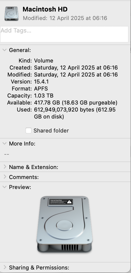

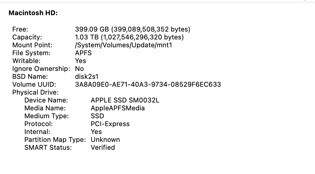

Thanks all for your suggestions. Not sure if I have a SSD memory or not. It is a Fusion Drive and when I chatgpt for a solution I have found solid state = yes (if that makes any sense). So I think so.

"Fusion Drive" means that your iMac has 2 storage devices. One is a 1TB HDD (has a spinning platter, NOT an SSD.)
The other device is a very small SSD, probably 32GB.
The 2 devices are joined by software, so you will only show one drive.
On the other hand, RAM (random-access memory) is not part of storage, or your fusion drive. RAM is volatile, which means that if you shut your computer off, you immediately lose everything that is stored in RAM.
Storage (your hard drive, or your Fusion drive) is not dumped when shutting power off. That's where all your apps, the Mac system, all your files and documents are all stored. That does not change, unless you make changes to it as the user.
I still suspect that you may have a failing drive (or simply is not working as well as it did when new). Again, that's where everything is stored, and that's where your system software is accessed.
If the hard drive (your Fusion drive) would need to be replaced, it is not a simple job where you can do "something" through a simple access panel on the back.
AND, you may also not have sufficient RAM for the software that you would like to use, including Garageband.

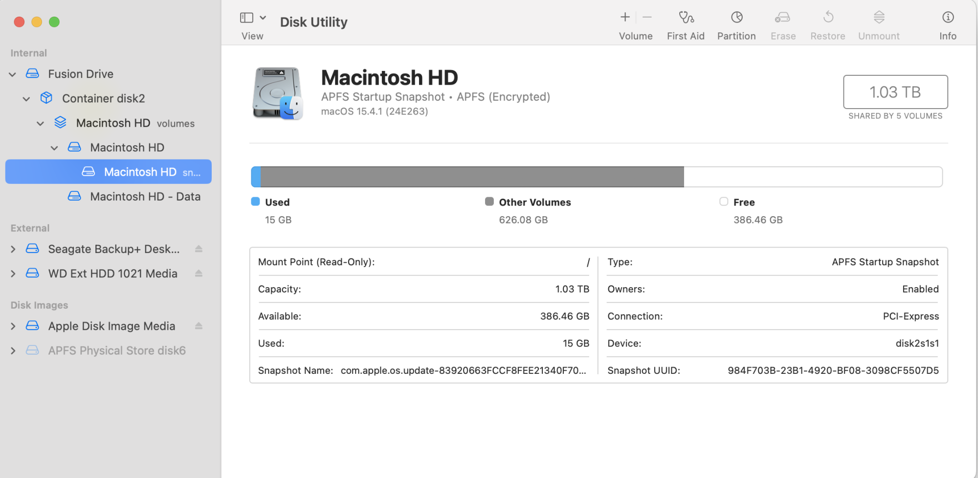

At a glance, I don't think that's a Fusion drive; your screenshots appear to identify it as an SSD. To find out with certainty, you could open Disk Utility, as it should tell you very plainly that the volume is made up of either one or two drives and identify the drive types. (I think the disk info window you captured would probably also say this... but as I've personally never trusted the Fusion drive concept in the first place, I don't have one to compare.)

this is what I found from disk utility
Well, that does seem to be fairly clear. I guess it's a Fusion Drive after all. Huh.
(I still think your primary culprit is RAM... but yeah, you probably want to do something about that Fusion Drive at some point... preferably at the same time.)
