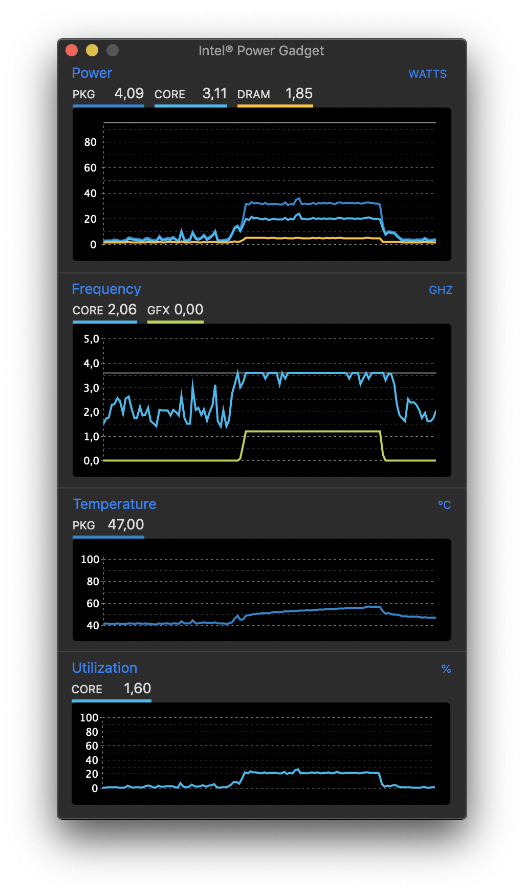

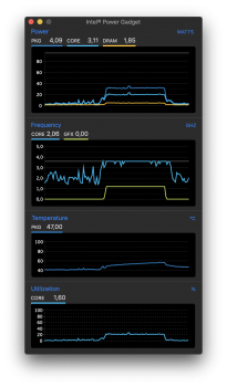

On mine, I get these results:
Source Clip: 5:38, 1080p, H.264, 17.7Mbps
Project: no transitions, titles or other effects, just plain source file on timeline
Faster Encode: 1:03
Better Quality: 1:45
Both create a H.264 file with 20Mbps bitrate.
In both cases I see Quick Sync being used (GFX wakes up to 1.20GHz):

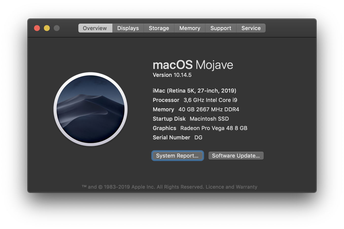

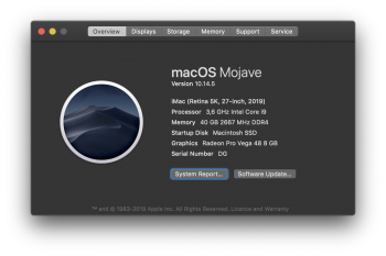

PS the RAM I installed, is this from Crucial.
Put 32G 2400 RAM from other machine in and now get ~5:10 render. Really about the same as the 2017 580 now. I wish I could say exactly what the footage was but it is ~4:20 in iMovie. It encoding to 1080P (Better quality), Faster setting is 2:56. Couple of transitions and a title. Seems more in line - though I did think it should be 10% faster just from CPU speed. Could be an iMovie issue since cores are not being worked very hard 🙂
