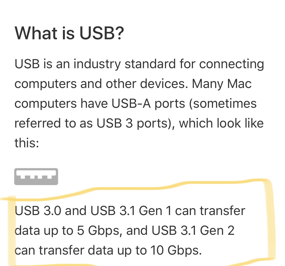

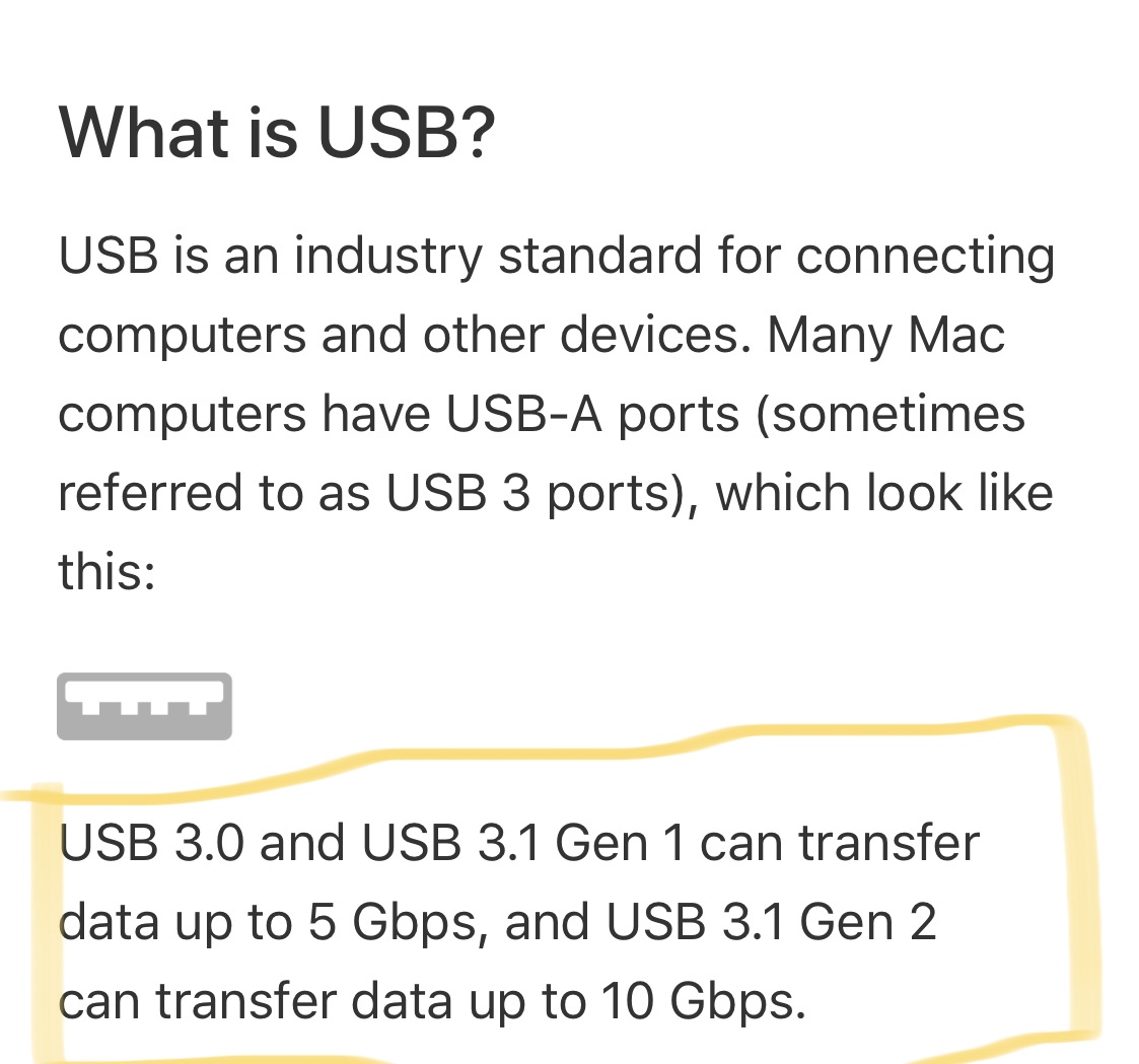

Their site doesn’t make it clear. Technically there is no USB 3 anymore it’s either 3.1 Gen 1 or Gen 2.
I do not see it state anywhere that it is 3.1 gen 2. It just says USB 3. It states the thunderbolt can support USB 3.1 Gen 2
It is very unclear. It says USB 3. Doesn’t say if it’s 3.0 (which the term doesn’t exist anymore),3.1 Gen 1 or Gen 2.
Yes it does:
USB 3.1 Gen 2 can transfer data up to 10 Gbps. Newer Mac models with Thunderbolt 3 (USB-C) ports support these speeds.
Only the TB 3 USB Type C ports are 3.1 gen 2.
All the Apple specs say USB 3 (same as saying USB 3.0). That is a standard will exist for ever - standards never die, they just become superseded.
USB 3 is very similar to the USB 3.1gen1 and USB 3.2gen1 standards, just not quite the same. All are up to 5 Gb/s and backward compatible to USB 2.
The 4 big USB-A ports on the iMac are USB 3. And will work with devices quoted as being USB 3.1gen1 as well as USB 3 and USB 2 (or even older).
The 2 smaller USB-C ports can use either Thunderbolt 3 (40 Gb/s) and USB 3.1gen2 (10 Gb/s).
Note that USB-A and USB-C refer to the standard for the physical design of the port. USB 2, 3, 3.1, etc. refer to the signalling and data transfer standards. Have a skim read of https://en.wikipedia.org/wiki/USB_3.0
