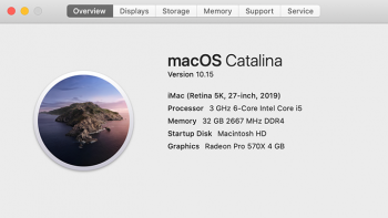

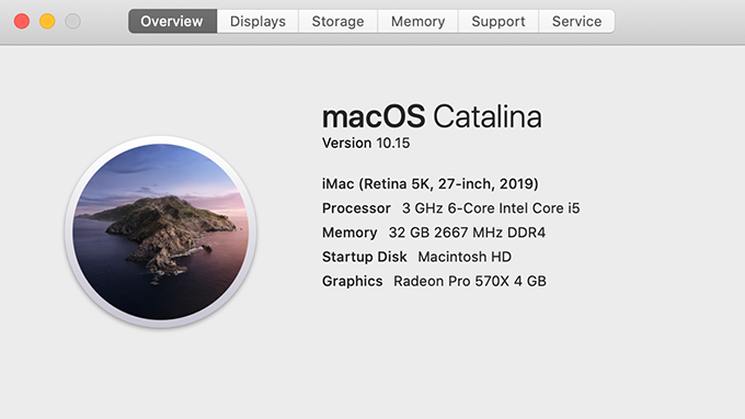

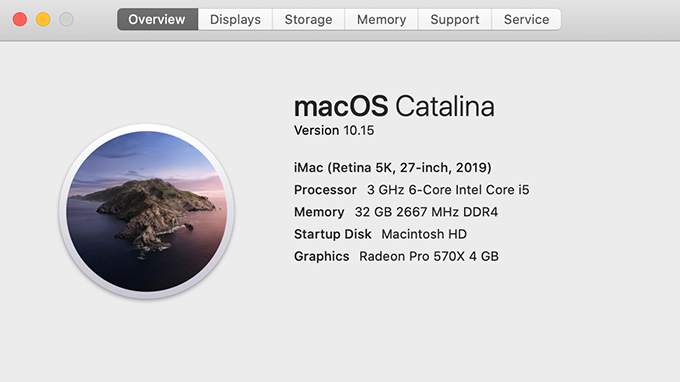

I am very sorry for missinformation.
So I have attached my mac model and meantime I find out that I don't even need the thermal sensor 🙂
I have this https://eshop.macsales.com/item/Other World Computing/S3DAPT4MA05K/
Also this https://eshop.macsales.com/item/Other World Computing/SSD7P6G480/
To replace the Fusion Drive.
I also have a caddy https://www.celo.ro/ssd/adaptor-fixare-hdd-ssd-2-5-in-bay-de-3-5-suruburi-de-fixare.html
My single problem now is that I don't have that Thermal Sensor and I would like to know if I really need it or I can proceed without it like here:
Thanks a lot

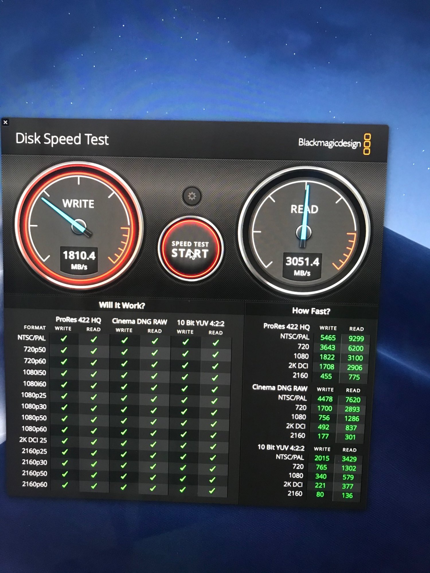

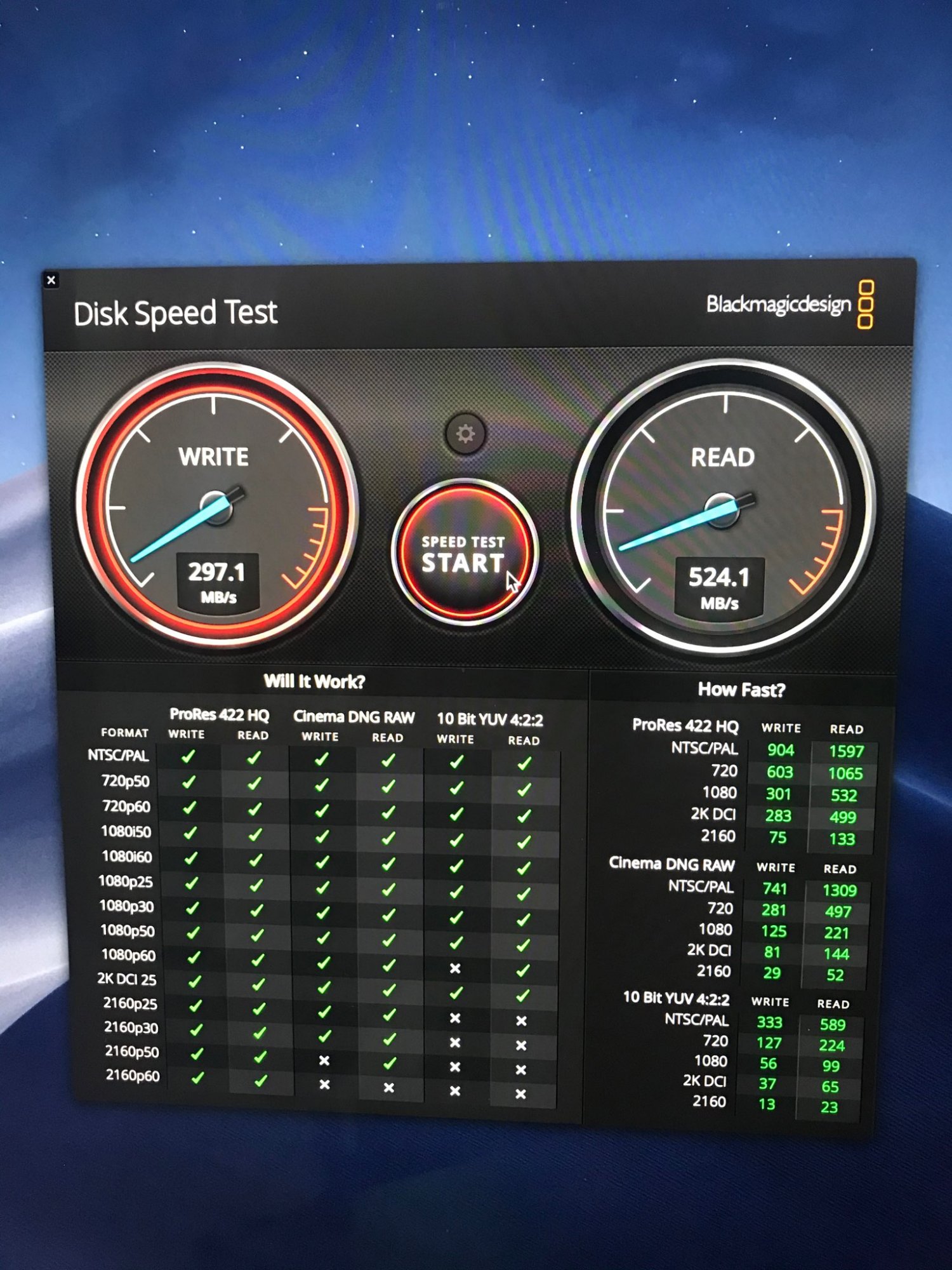

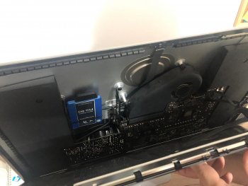

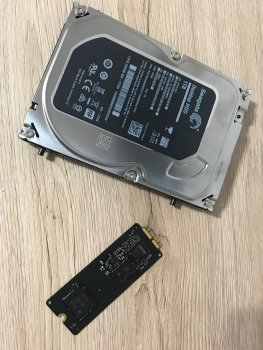

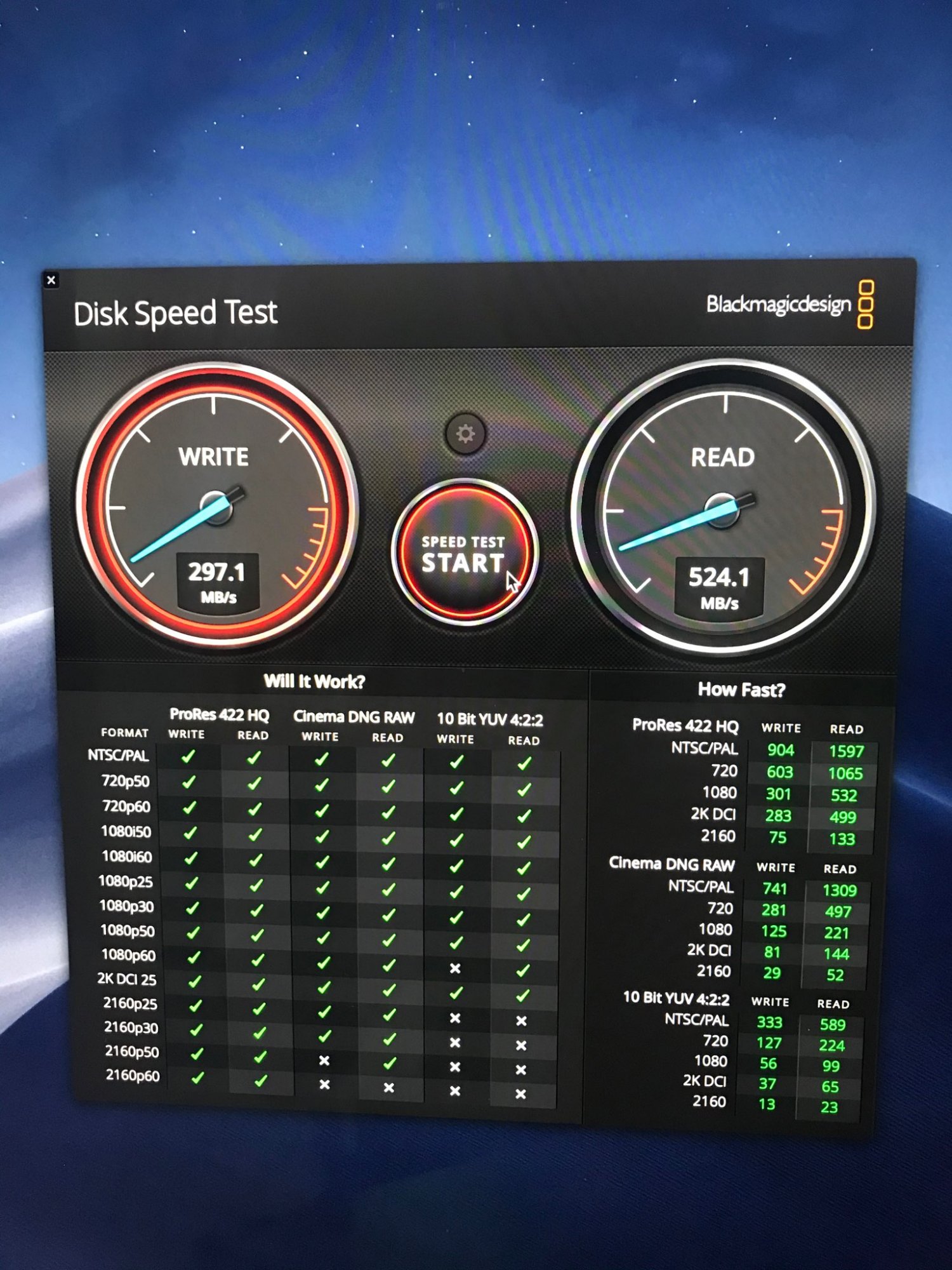

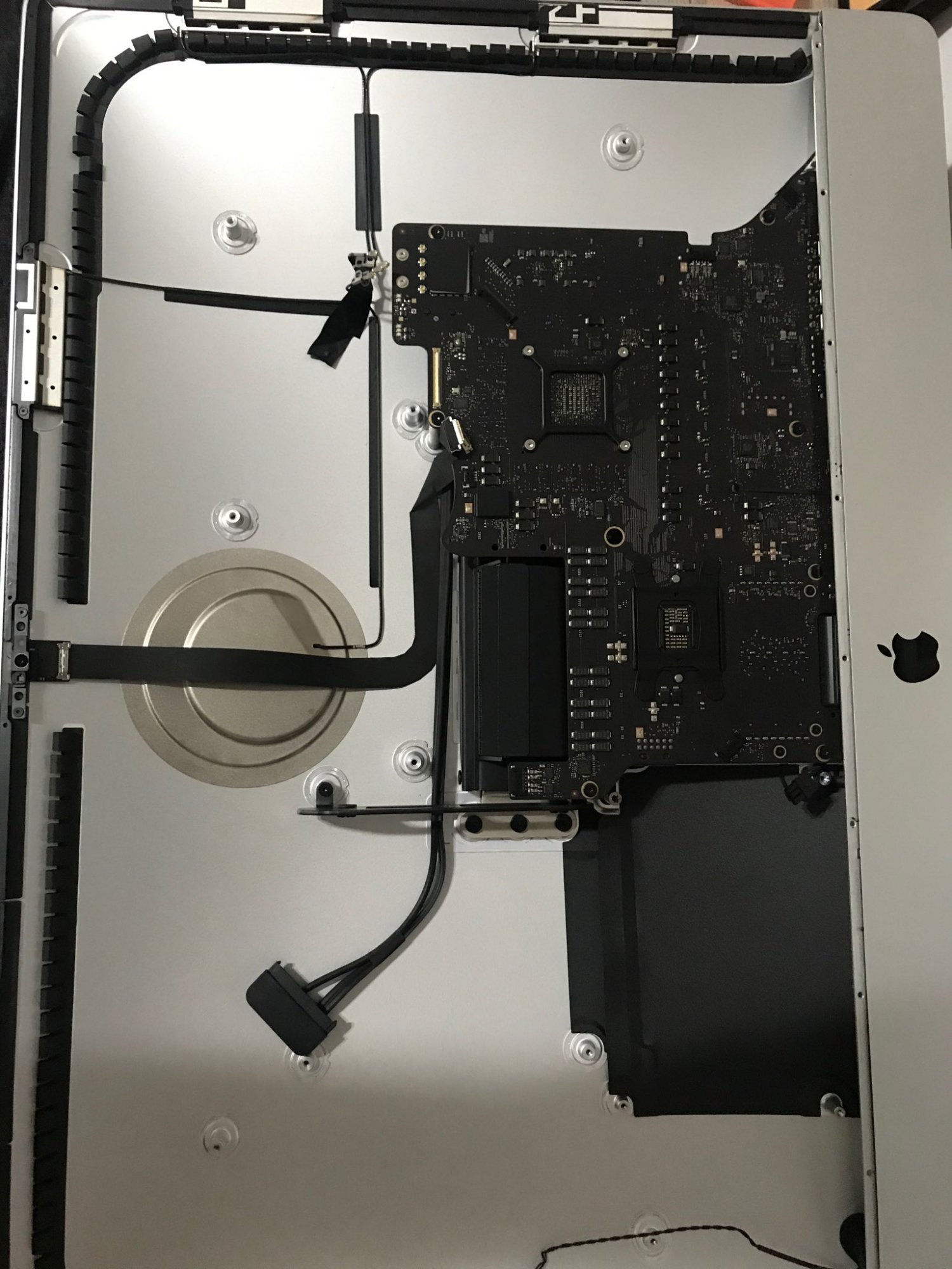

Hello everyone!
So:
I come to you with fresh news. I just installed my two new SSD to 27 inch iMac @2019 and works good.
I will let you some pictures attached to see.
As you can see, I've changed the blade, also the HDD.
The new speed tests in the pictures
The big one is for PCIe Aura Pro X2
The low one is from Mercury SATA Extreme 6G
If anyone wants to know any other information, please ask. I will try to help you guys.
