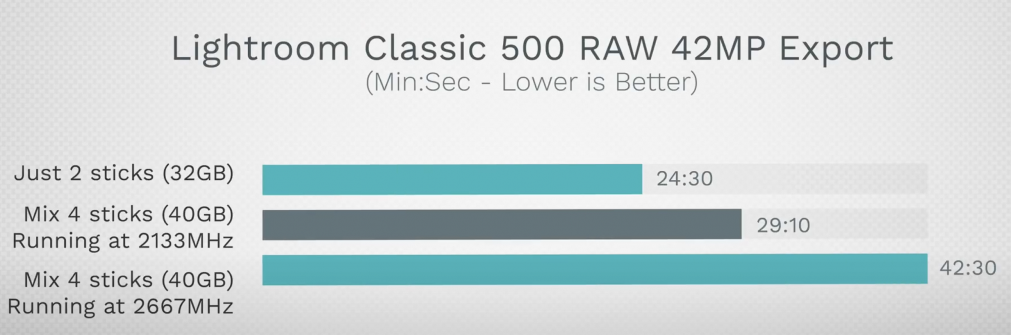

Yes, it runs, but not "perfectly." MaxTech investigated this in their Youtube video, for example. The results clearly show that mixing different sizes of RAM, no matter how you arrange it, degrades performance. This has been confirmed by multiple people, myself included. (If you really need more than 32GB, suggest get 64GB of matched sticks.)
See 7:02 in their video for explanation:
Reactions: pldelisle
Thanks, what confirmed it @fronesis ?
Just the video that Wilberforce posted above: it's pretty conclusive.
For the record: I was *not* running my setup in single channel mode, because I didn't put the same sizes in adjacent slots, but my ram was throttled back to the slower rate – and I'm sure the video benchmark results were affecting me.
For me the difference between 40Gb and 32Gb will be completely imperceptible. I had just left the original apple 4Gb chips in because I didn't think they'd be of much value on eBay and I had no other use for them.
