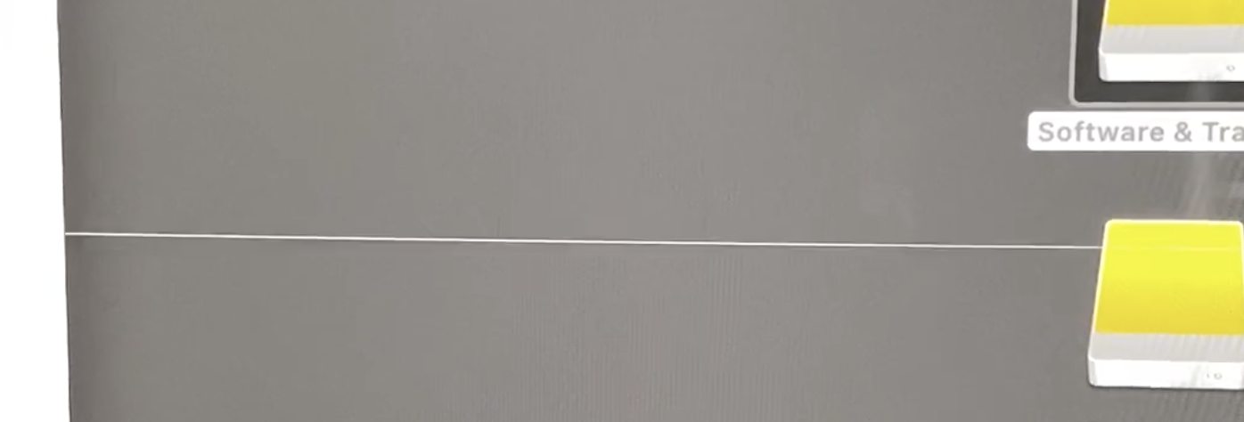

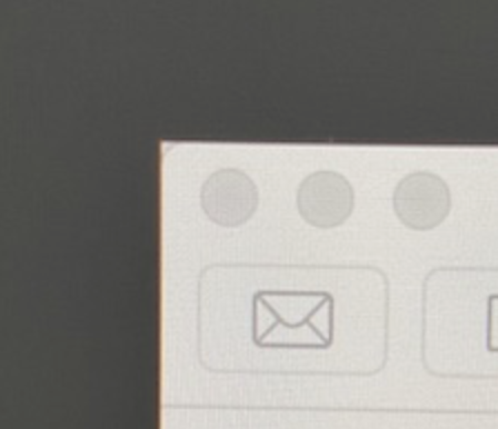

My experience of the 2020 iMac.
3.8 GHz 8-Core / 64GB / 2TB / 5700XT
Random white line.
Square corners to program and finder windows.
Font descenders sometimes sheared.
Gets knickers in complete twist with spinning beach ball finale... requiring hard, power button reset.
8 days old, I have a case number and it's going back to the fruit shop.
Was hoping to replace my trusty 2012 MacPro that's never missed a beat. Hey-ho.
Reactions: kkh and dspdoc

Did you actually capture the white line with a screenshot vs an external camera? As far as I’ve seen on this forum no one has been able to do that thus far. Anyone else?

I haven't seen the font descender issue and the beach balling sounds like either an issue with your specific Mac or perhaps some software you are running. I am guessing your 2012 is not running Catalina?
My 2020 has about a 20 day uptime at this point.
First time seeing the white line right in the middle of the screen over the Catalina rock formations (between software update window left and contacts on the right side of the screen).

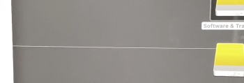

In answer to the questions.
Will I get a new one? - Yes... apart from the issues it was a joy to work without proxies on a 4K 10bit timeline that had no lag at all... but I may wait for the dust to settle before pulling the trigger again.
White line - screenshot or camera? - I uploaded a screenshot from an iPhone video taken this morning.
I spotted the descender issue in OSX Mail, the beach ball appeared while using Premiere Pro (yes, I know, I know... but it's what I use).
As a side note, when Adobe updated PP earlier this week I did notice it seemed to make much more use of the video card.
....the cheeky little white line just said hallo again, I think I'm going to miss it.
