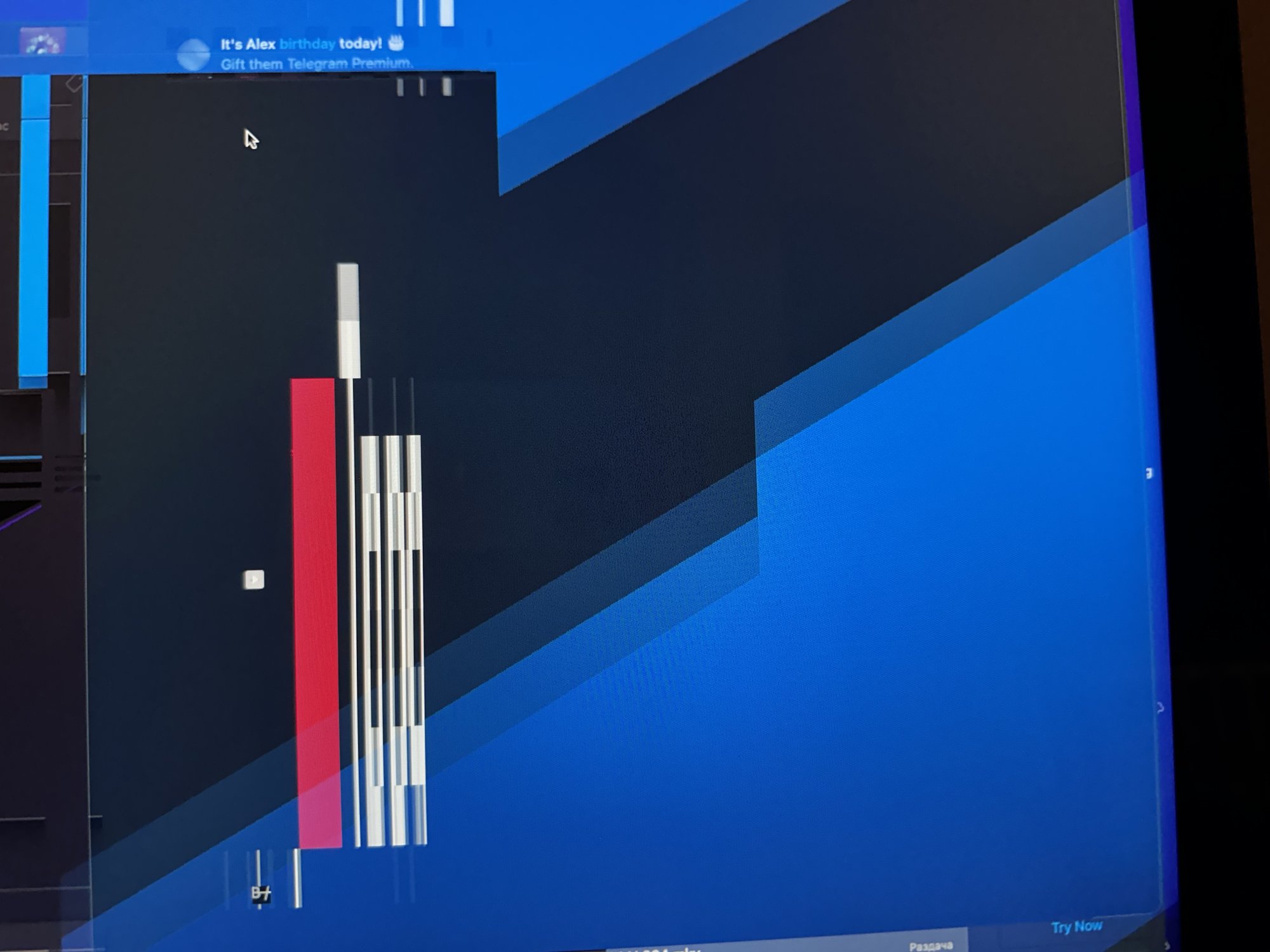

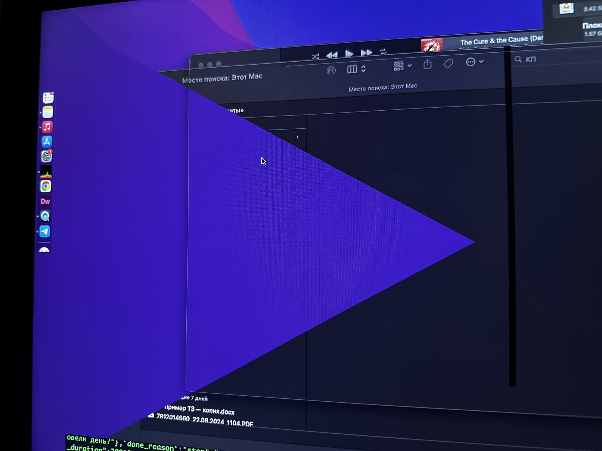

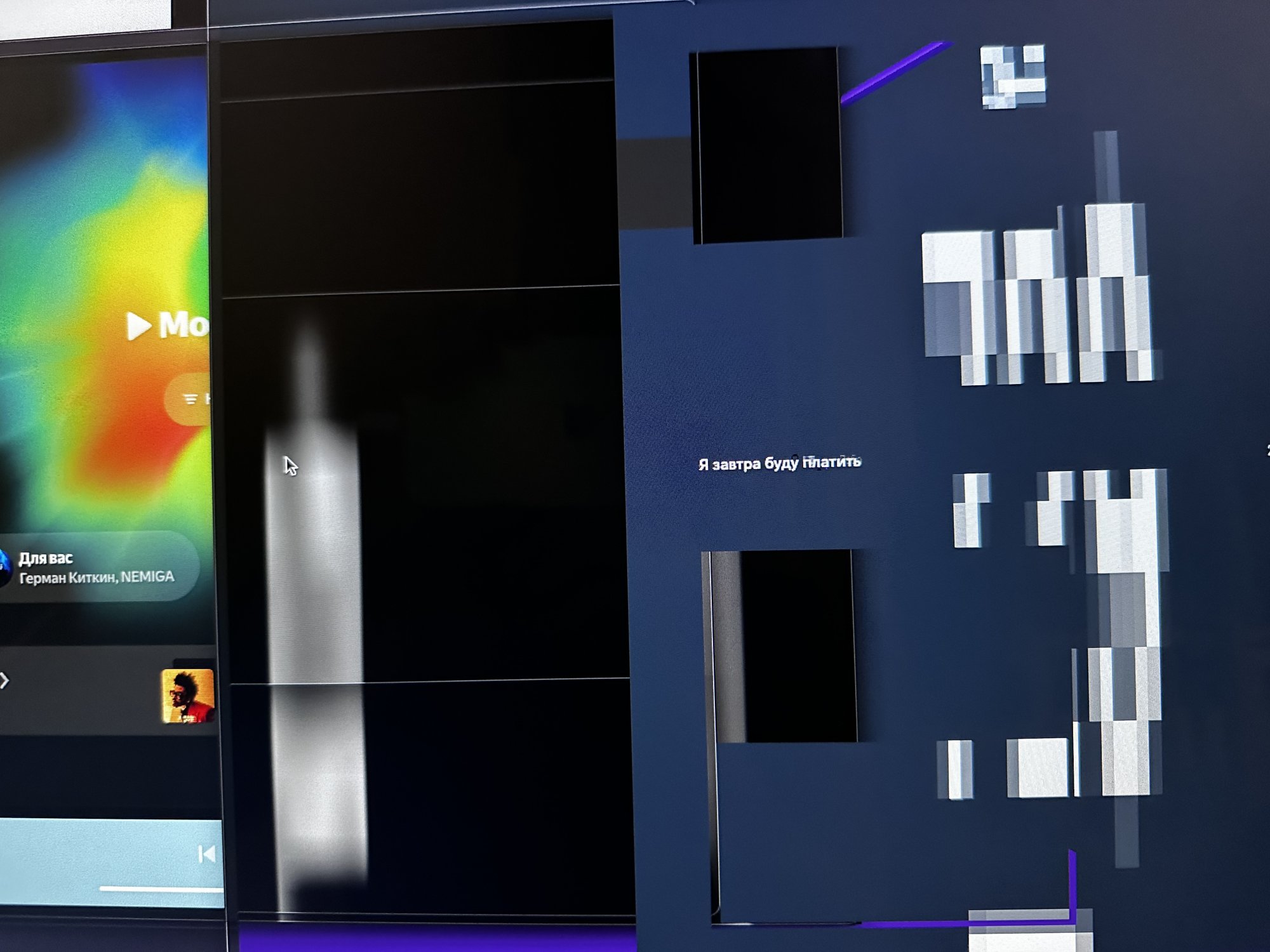

Hello, Sometimes such a problem happens - the image breaks and flickers.
Has anyone solved this? What could be the reason?
Please help me fix it.

This is not always. This happens During normal use or after the screensaver. It works fine 90% of the time. And sometimes this happens. Reboot fix it
This is my iMac late 2012 configuration with OpenLegacy Patcher 2.0.2. Everything was working perfectly and smoothly, but suddenly it started showing screen artifacts. I believe I'm experiencing the same issue as you. I’ve attached a video of the problem.

The graphics processor or memory chips on the video card have fallen off. To repair
Repeated strong heating followed by a sharp cooling in the chips appear micro cracks and oxides, gradually leading to the so-called “falling off” of the chip, when one or more balls lose contact. The reason is simple - to this day Apple thinks with its sciatic, not its head. They've never studied physics. The cooling system is disgusting from an aerodynamic and efficiency point of view.

Yes, they can desolder over time. One or several - you need to open and look. The main thing is to find good masters, because illiterate and inexperienced will immediately “reboll”.
yes, this is the same problem
Does your mac work correctly on previous versions, example on Bug Sur?
my work fine on Big Sur
An interesting fact is that if you do not use Safari, then there are no screen artifacts
