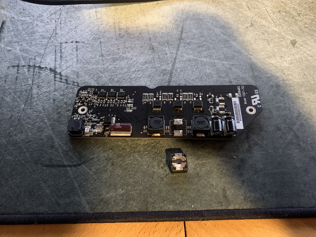

But now, if I shine the flashlight on the screen, I can see something. So I checked out the inverter board. And then I saw that one of the coils was missing. Looks like it got so hot that the solder has softened. The coil was at the bottom of the case. I soldered the coil back on, but it didn't work. Looks like the inverter board is broken. I have now bought one on ebay. That should arrive after the holidays. I hope this will get the iMac working again.
After 6 weeks of waiting I finally got the inverter board. The iMac is now working again. Thank you for your help.
