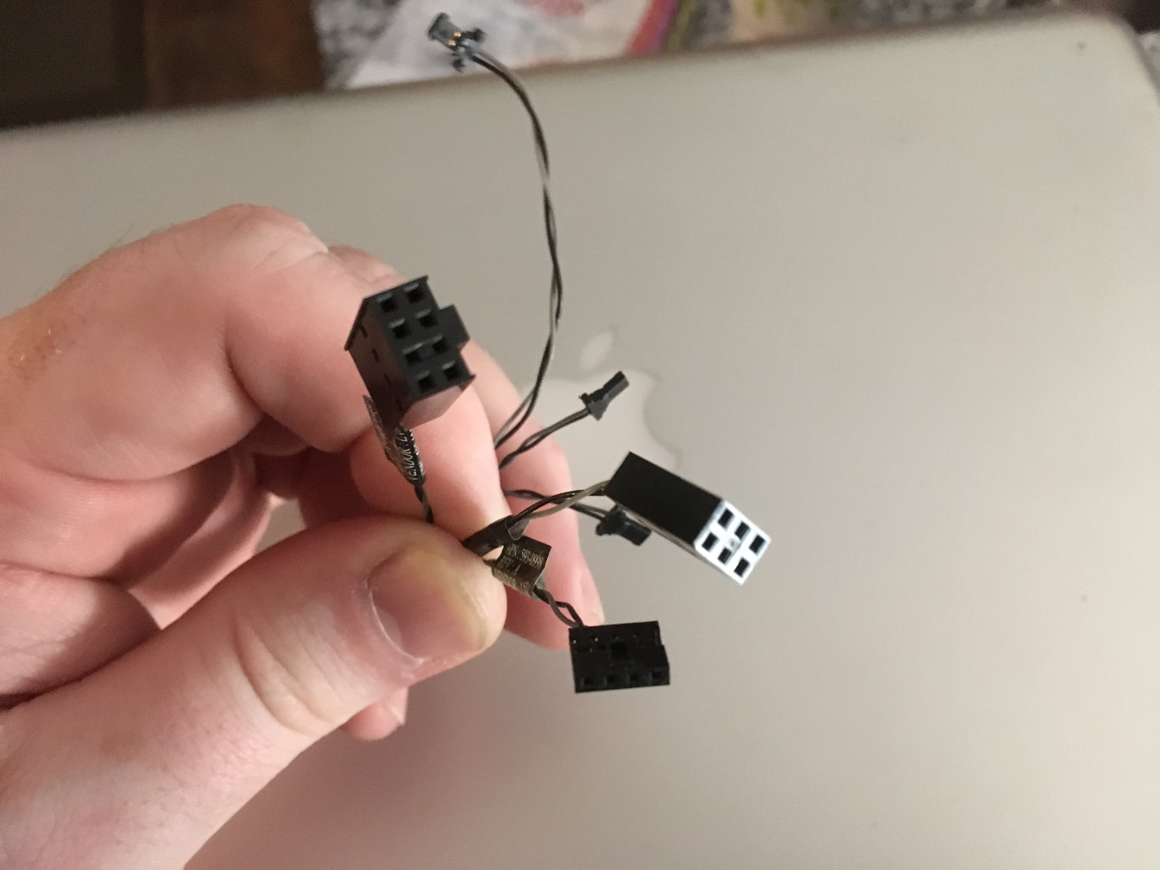

my imac mid 2010 wd hdd fail so i bought a new seagate 1tb at that time i didnt know that it will happen with this hdd temperature sensor, that fan will run in a full speed,
i done a research, and i find out that there is a 3 types of hdd temperature sensors, wd, hitachi, and seagate, and they all different shape,
so my question is cos now i dont have wd hdd and i replaced it with seagete, if i will buy a new hdd temperature sensor from ebay for seagate , is it will work , cos i was reading yes you can use hhd fan control software and i tried which worked perfect but ,i have to pay 28 pounds which i dont want to, or you can short but also i am not to sure if that will work, but people say yes, it does,
so what i did i tried to connect straight to hdd those 2 wires black/and grey, cos i looked at google
https://d3nevzfk7ii3be.cloudfront.net/igi/uo5O5NJPCoqZxEh1.medium
and i done the same, but for some reason it is not working then fan after some time start running at full speed,
so now i dont even know if it will work with a new seagate temperature sensor cable , cos i i connected exactly the same 1 pin black, 2 pin grey.

My understanding is that for the drive to work correctly, it must be an apple-branded rotational hard drive and have apple firmware installed. I'm aware of three different connectors for Hitachi, Western Digital, and Seagate.
That's why the 2008/2009 ODD sensor is a better fix, because it operates independently of the drive used, and has the added benefit of working with SSDs or no drive at all.
What is the issue with fit with the hard drive? My understanding is the sensor cable plugs into the motherboard (or other board), and the sensor itself is taped onto the drive. In my case, this is an SSD.
Will a 593-0998 billed as a 'Seagate cable' work in my mid-2010 21.5 iMac?
The picture in Zeke D's #6 posting on using a cheaper solution points to a 593-0493. probably the same parts, different length of cable or other minor change? Any knowledge on this would be nice. I am not able to see the connector shape on ebay pictures, and the #6 post picture shows a small 2 pin connection on the mother boards.
Or would this work:
https://www.amazon.com/ITTECC-Repla...ywords=593-0493+iMac+temperature+sensor+cable
The three connectors I showed in post #6 only work if the drive is apple branded and has the apple firmware on it. The 593-0493 is an optical drive thermal sensor from a 2007/2008 iMac. You tape the thermistor to your rotational drive or SSD, and plug the 2-prong connector into the logic board. I recommend positioning it on your replacement drive so it lines up with the center of the plastic air duct of the middle or HDD fan.

I see it now. The drive specific cables have a plug on each end (hard drive on one, motherboard on the other).
An alternate arrangement is to put in a diode or transistor to replace the hard drive end - per this post which includes your '09 ODD recommendation:
https://forums.macrumors.com/threads/2010-imac-hdd-sensor.2065341/
or put in a jumper (very 'Russian' according to this German - too funny)

For the 593-0493, I'm not sure what kind of sensor it is, but Apple has been using them since they started with intel CPUs in 2006. The different part numbers just correlate to different wire lengths, logic board connectors, etc.
Here are the reasons I'd recommend the 593-0493 over all other solutions:
1. This sensor will still control the fan speed when the unit hasn't booted to the OS. This includes installations, and target disk mode. (macsfancontrol requires the OS to be logged in to work.)
2. Since it's an apple-branded product, you know it's compatible, and that there is little chance that it could damage your unit.
3. There isn't a lot of extra material that has to be hidden or tucked away. it's precisely the length to be routed with minimal slack, as to not obstruct airflow.
4. Mounting. If you are uneasy simply using a piece of electrical tape (or thermal metallic tape), you can purchase a plastic mount for the sensor: 922-8183 (They're about $1 - $3 online)
5. Price. These sensors are so readily available, that they cost less than $5 per unit. (I purchased six of them so that I'd have extras, since the 2010 iMacs are being phased out by universities, etc.)
6. It will fulfill the requirement for Apple's hardware test, resulting in an (exit; 0).
7. Myself and two others have tested it out on multiple 2010 27" & 21.5" models. I've installed them into 8 units to date, and each of them perform as expected.
