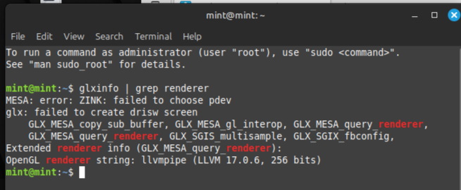

From experience Linux Mint on this model iMac starts with software rendering (llvmpipe) by default (and on any machine if started in compatibility mode).
You could check if this is the case by running
Code:
glxinfo | grep renderer
in terminal. If the output shows llvmpipe or LLVM it is using software rendering, in which case you have not tested the GPU.

I ran it and it does says llvmpipe in it.

So Linux Mint is using software rendering.
