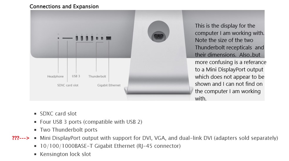

I am trying to help a friend who owns an IMac 21.5, Late 2013 desktop and want to connect the square Thunderbolt 1 receptacle to an HDMI adapter in order to provide an external monitor. Most information I have found refers to Thunderbolt 2, 3, or 4 connectors and I have found no cables with the square, not oblong or rectangular, plug to match the receptacle. Any help would be appreciated.

Thank you, however, all photos of mini display port seem to show plug with dimensions with rectangular but not the small square size dictated by the computer receptacle.

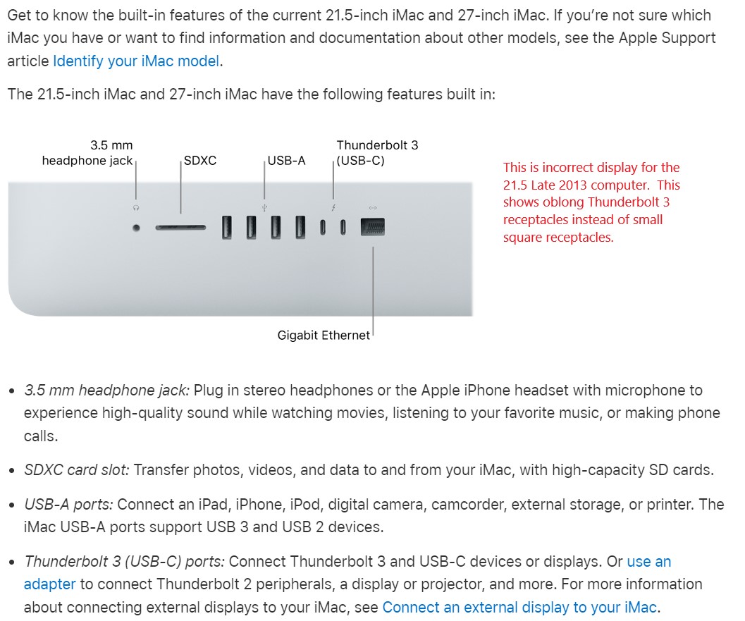

Thank you again. It seems that I have mis-stated the name as Thunderbt 1. The computer documentation only states "thunderbolt". The 21.5 Late 2013 IMac has two Thunderbolt ports, both being Small square dimensions. I have tried both a mini display port and a USB-C cable, following direction of documentation supposedly for this computer but apparently for the 27 inch system. The plugs of the cables I tried are too large and are not square
USB-C is a different connector, and will not with with Thunderbolt (1 and 2) without additional adapters and equipment. Definitely overkill for what you are trying to accomplish.

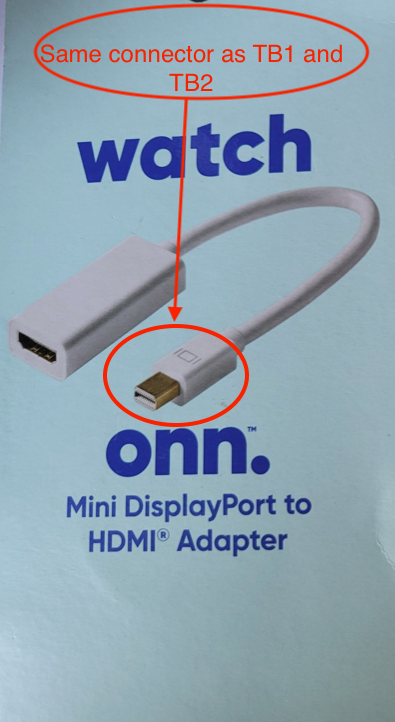

Thank you, again. I am attaching photos that will make my statements more clear, I believe. The PDF contains both IMAC pictures. The last photo is of the cables I have attempted to use.
The MiniDisplayPort to HDMI adapter shown on the left is the correct one, and it plugs into either of the two Thunderbolt ports on the back of the iMac just fine. The Thunderbolt ports are also MiniDisplayPort outputs. This is called "DisplayPort Passthrough".
As @Amethyst1 said, this is the correct adapter:

Just make sure you are matching the plug to the port, and it should just plug right in.

Well, I will be ??Ssdfsdf???, you were/ are correct. I was looking at the back and must have seen a parallax view that gave the appearance of the port being square....BECAUSE when I ACTUALLY TRIED IT, the plug FIT.... And everything works...
